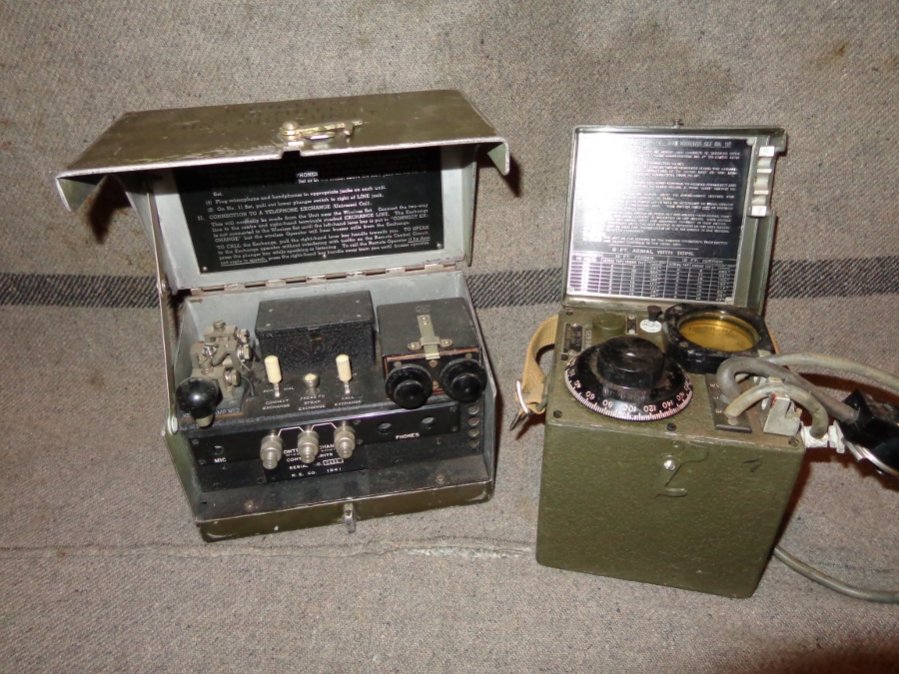

Old 22-07-16, 02:15
Default Additinal
Face cover, Coupler C and Remote Control Unit A

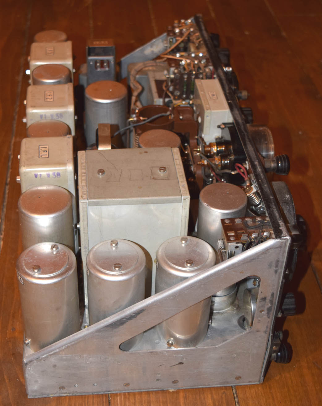

This British set I just acquired looks to be in the best shape of any of them. In the end view you can see the markings on the carrying straps with the ZA number. Would these be original? They're in pristine condition. Note there's no corrosion on the pins in the connector sockets on the set. The lid has rivets on the hinges too.
They certainly look like it. ZA.8403 dates back to the original numbering of the VAOS, and is earlier than 1940 (since there are higher numbers in the 1940 VAOS - which pre-dates the WS 11 (it has WS1 and WS9, etc. plus much earlier stuff listed)). I assume it was an existing item when the WS11 came along.
That set is in astonishing condition!

I took the case off and look what I found! It's immaculate! No dust, no crud, nothing! The dealer I got it from never touched it. He got it from an old time collector in Calgary who had it for many years. He likely got it from the military as the second owner.
That list of components is on the inside back of the case.
The ZA number on the carrying strap is listed in the Australian 11 set manual.
