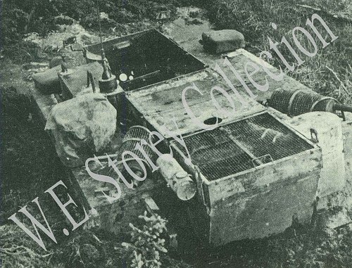

Here are a couple of photographs of Canadian machines on Exercise in Churchill in 1946.
Name:	Fig. 120 - Snowmobile Negotiating Bank of Creek.jpg
ID:	88697 Click image for larger version
Name:	Fig. 173 - Snowmobile in Floating Bog.jpg
Old 15-02-17, 22:07
Posts: 3,721
Thanks for posting these photos, Ed.
The left sponson box looks to be an armoured bin for the 19-Set. B-Set aerial base set in forward outer corner, with perhaps a strap iron brush guard aft of it for the A-Set aerial. That is quite an interesting mount and base combination for the A-Set aerial as well.
Take a look at the cover over the 'Engine Compartment', immediately forward of the screened section of top hull. It looks to be divided into two sections across the vehicle, at the mid point. It also does not look all that flat in either photo. Could this cover be canvas or wood, perhaps? Showing a little waviness with age? Could it fold open from either end? Would the small circular opening at the back be for checking radiator fluid/oil?
Also very intriguing, as I know very little about these machines. (A) What is the nature of the small cylindrical tank running along the upper left rear side of the screened section? (B) there is a very large vertical, curved structure at the right rear corner of the vehicle. Would this be an armoured fuel tank?
Damn!!! I WANT ONE!!!
Thanks again, Ed.

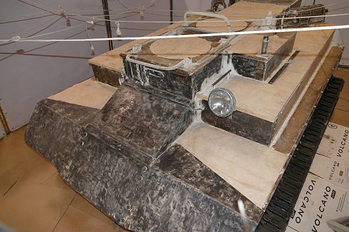

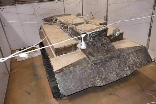

In " Design Record", vol 8 (Army Engineering Design Branch) it states " To minimize crew exposure due to the open top hull, two man-hole type flat plywood covers were installed over the drivers and observers seats. The front cover was hinged to the body of the vehicle so that they could be folded out of the way when not in use. Although of simple construction and easy to operate, it was found that the crews movements were somewhat hampered when the covers were in the closed position" . I don't know enough about military protocol to know if this was recognition after the fact or whether the plywood top was officially sanctioned and promoted.
Looks you are correct on the plywood, Bob. These pictures show the Kubinka survivor under restoration, showing the quite extensive use of wood. "Woody snowmobile"?!!
Pictures courtesy of Yuri Pasholok: http://yuripasholok.livejournal.com/8710201.html
PS: will merge threads later
Old 29-04-17, 19:59
Posts: 3,721
Great photos, Hanno. When you look back at Ed's photo post #6, you can see the angled wood/steel seam on top of the right front fender.
These things are just getting more and more interesting!

Given the apparent extensive use of plywood in the upper hulls of the Armoured Snowmobile, I am now rethinking the conversion process of them to early Penguins.
From the newly posted photos of the surviving Russian machine, it looks like a fair bit of the forward plate was either bolted, or riveted in place. There may not have been much cutting off of upper armour as I had originally assumed to reduce a complete AS to just it's lower hull assembly, ready for modification to a Penguin.
Be interesting to examine an early Penguin to see how the replacement upper hull was fitted. Might be easier than we suspected to restore one back to original AS configuration.

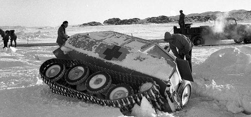

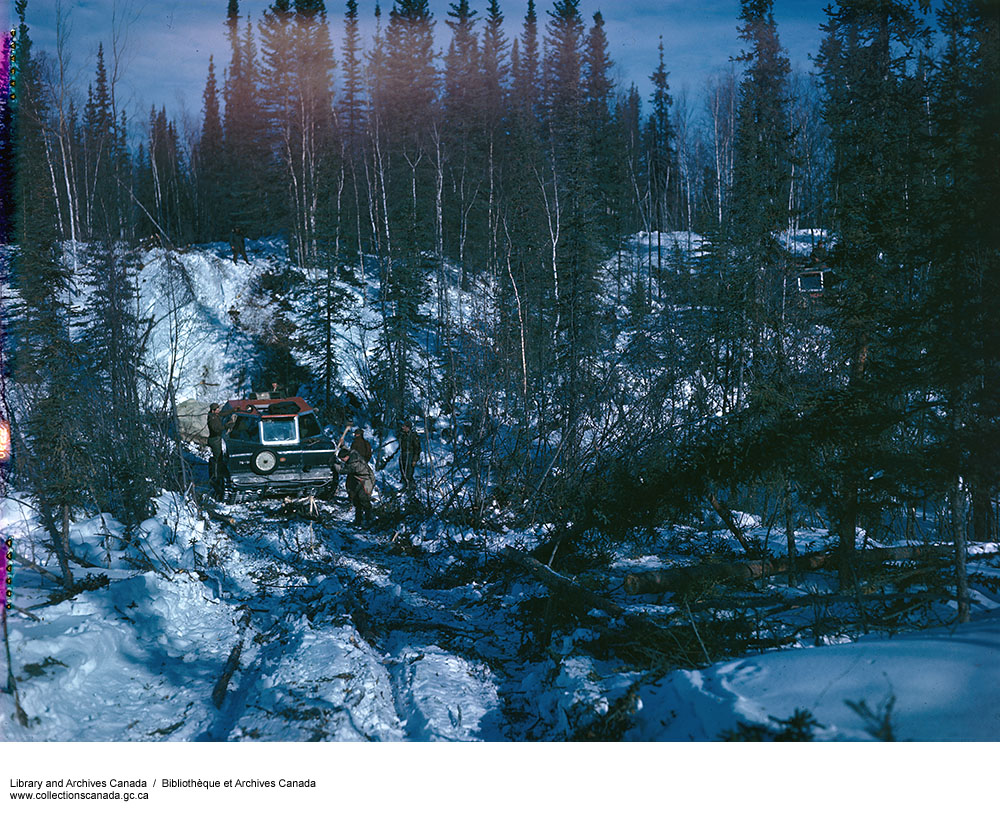

Found a pile of colour Operation Muskox photos online.
e010750518-v8.jpg   e010750519-v8.jpg   e010750520-v8.jpg   e010750715-v8.jpg   e010750716-v8.jpg
Old 01-08-17, 12:10
Posts: 4,192
And some more
e010750710-v8.jpg   e010750713-v8.jpg   e010750722-v8.jpg   e010750725-v8.jpg   e010750727-v8.jpg
Old 01-08-17, 12:12
Posts: 4,192
And more still
e010750729-v8.jpg   e010750732-v8.jpg   e010750737-v8.jpg   e010750741-v8.jpg   e010750747-v8.jpg
Old 01-08-17, 12:12
Posts: 4,192
And yet even more
e010750749-v8.jpg   e010750750-v8.jpg   e010750751-v8.jpg   e010750752-v8.jpg   e010750753-v8.jpg
Old 01-08-17, 12:13
Posts: 4,192
And even still more
e010750755-v8.jpg   e010750756-v8.jpg   e010750757-v8.jpg   e010750761-v8.jpg   e010750762-v8.jpg
Old 01-08-17, 12:14
Posts: 4,192
And yet still even more
e010750758-v8.jpg   e010750759-v8.jpg   e010750760-v8.jpg   e010750771-v8.jpg   e010750772-v8.jpg
Old 01-08-17, 12:15
Posts: 4,192
And some more
e010750869-v8.jpg   e010750868-v8.jpg   e010750870-v8.jpg   e010750770-v8.jpg   e010750768-v8.jpg
Old 01-08-17, 12:16
Posts: 4,192
And the last one
Old 01-08-17, 14:39
There is a neat shot of the blank fire Bren in a couple of those photos. Notice the odd muzzle BFA, and the yellow handle, along with yellow band on the carry handle and the butt.
Thanks for sharing the photos Jordan.
Old 02-08-17, 07:32
derk derin's Avatar
Join Date: Oct 2005
Posts: 857
Default Ambulance version
Yes, great shots and love the red cross on one of the vehicles!
Derk
