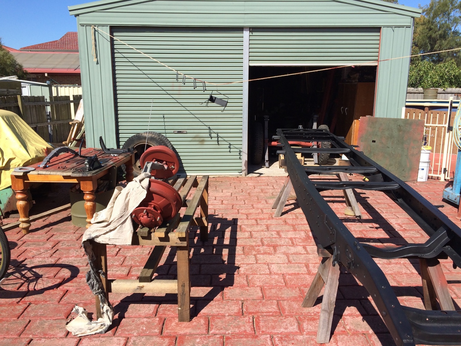

first job was to sandblast the springs chassis and diff ,
I disassembled all of the springs after sandblasting and wire wheeled and fish oiled in-between them. replaced the bushes and dad made up the nylon spacers for the front . I found that one side at the front was sitting lower so I had to take it apart again and went to jack nevilles house and he helped me make the spring more taught and now its sits more level.
the front bracket that holds the bumper and front shackle was broken and "farmer joe" welded so we had to make a jig and bolted together to re-weld it in properly.
when these trucks came to Australia the Australian army put 8mm strengthening plates along the side .Unfortuntly mine started to de-laminate so I had to cut the rivets and drill them out and make up new plates and bolt them up
the crown and pinion gear was to worn so couldn't use the original , good thing about the banjo diffs that I could keep working without waiting on the diff. I eventually found one and pick it up at corowa last year

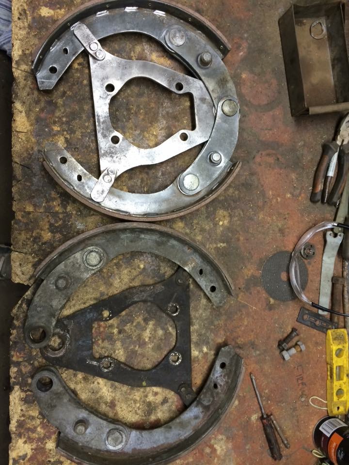

Next step was to pull apart the steering box , overall it was in good condition just gave it a good clean , re greased everything and made new gaskets for it.
Sent in my radiator to get re-cored. the guy ended up using a hilux core and re-using the top tank and making it work with that and the bottom tank he fabricated to fit in the frame. the cores abit thinner than the original but you wont reallt notice in once everything in , I wasn't going to spend $2,000 on an NEW original honeycomb core
The last photo was the diff in the vise , with me about the check the backlash of the gears

so after everything got sandblasted and got new bushes for the shackle pins, I got everything put back together and painted and started working on the steel work of the tray.
when most of these trucks came out here , the aussies put an 8mm strengthening plate along the side of the chassis to beef the load capacity to 3ton
mine started to delaminate so I had to take it of and make up new ones. the originals were riveted on, instead of re riveting it I brought 13mm bolts and bolted it back up , and then ran a bead of truck silicone on the joints to prevent water from getting in there again
