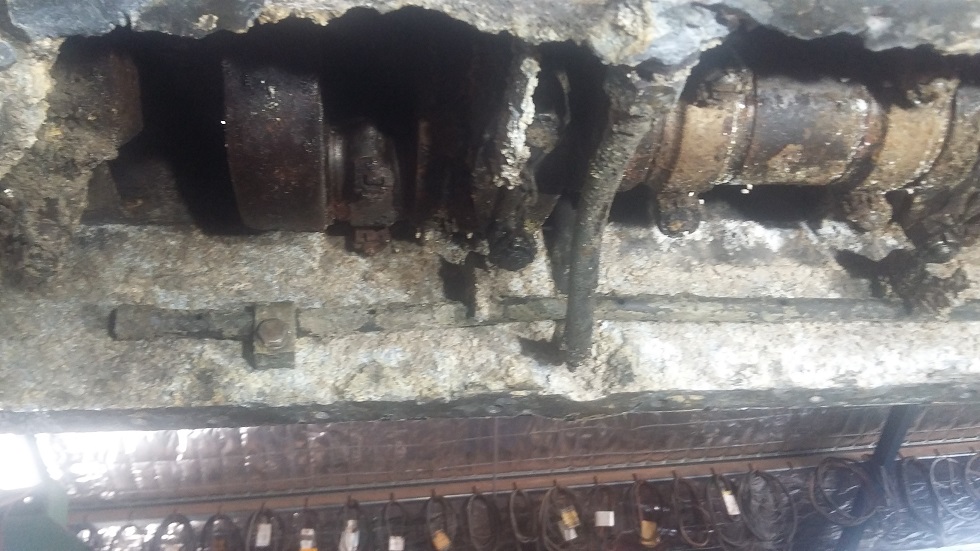

After removing the sump as gently as I could it was not a good sight. One corner is all but corroded away and a section of the floor as well and I havn't looked inside yet. Also the crankcase spacer is also quite corroded as well. I knew it was very thin walled as I could hear the sound just tapping it. Rather disapointing

I may have to re-evaluate this engine The crank appears to be good and I see it does have sleeves but the bottom is a mess. I will consider fabricating the whole bottom section but that will be a last resort as some of may have been line bored and that is not something I can do if it requires precision.
At this stage I will weigh up my options so far.

Colin.
Bit of a shame with regards to the engine corrosion. It looks from your photos the main engine block assembly is in three parts. Upper holding the cylinders and pistons, middle unit holding the crank and related bits and then a lowermost cast, flat looking rectangular oil sump. Interesting design, if true. Could make for a lot of flexibility for various installations, but also a lot of headaches for restorations. And, of course, the latter point would not have been on anybody’s radar in the Meadows Design Branch in the 1930’s.

Hi Col', with a bit of luck some of the lagonda folk may have a solution.

Colin,
The Lagonda club appear to have had some new sump castings made, maybe they are adaptable for the tank engine?
https://www.lagondaclub.com/shop/m45...eadows-engine/
I think the sump you have could be made of Elektron, a magnesium alloy, it was also used to make the mantlet in the turret.

After a closer look, I can make a new sump and the riser above (I'll call it that)
But I will get the rest checked out first to make sure the top pieces can be resurrected. David, it has a sump, riser, crankcase, block, head, cover. Lots of bits that have to line up precisely. Quite a complicated system.
Dave, I have joined the Lagonda club but waiting for approval.
Richard, I would say you are spot on what it is made of and would be very hard to weld which is why I would make the parts out of steel if I do in fact go down that path. They certainly don't look like difficult parts to make but I do not want to create any more work that I already have. Hopefully the members of the Lagonda club may be able to steer me in the right direction.

can you not build up the corroded sections sufficiently to make a pattern to re cast a replacement ? I have no doubt this would be a very long process, but big hurdles have never stopped you in the past ?
looking at the corrosion product, it wreaks of dissimilar metal corrosion. I feel for you matey.

As I mentioned to Colin recently, I believe the sump and its adaptor were made of a magnesium alloy called Elektron, which was very much in its infancy when this Vickers was built. It had a tendency to corrode in the early days, but later developments made it much more resistant to corrosion, just look at all the grey Ferguson TE20 tractors from the late 40's/early 50's that are still around, the gearbox casing was made of the same type of metal. It is very tricky to weld and need to be careful as it will burn. The fabricator that restored the hull of another of the Aussie Vickers MkVIa tanks brought back to England, had to build up the mantlet where it had crumbled away, it was a painstaking job, I think he was using TIG as I recall.
I don't think it was a case of dissimilar metals, but just an alloy susceptible to corrosion or breakdown.
