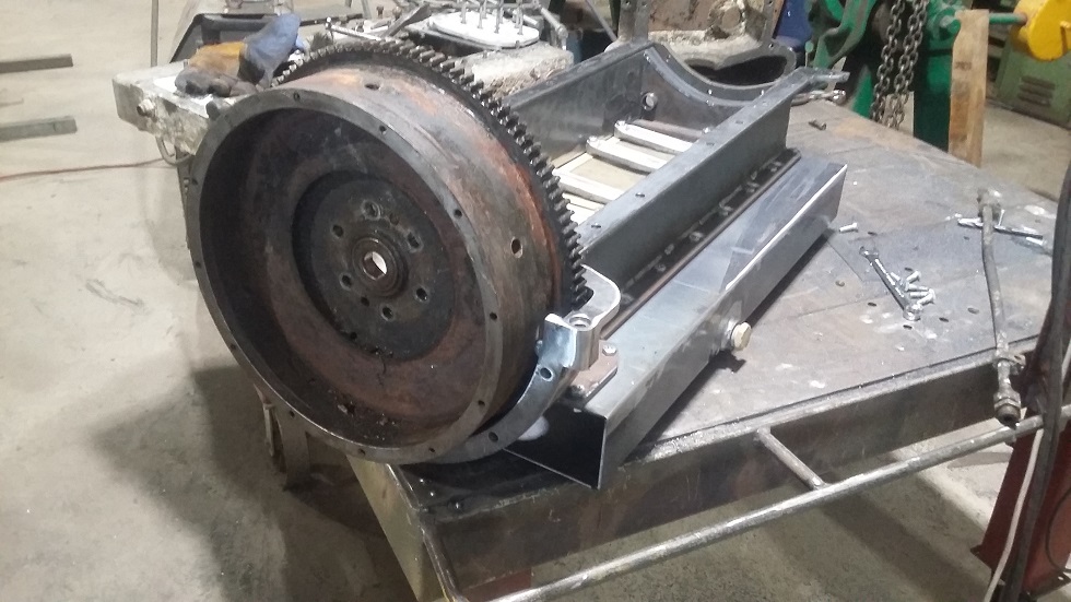

I know it's been a while between postings but I had a job to do for some one so here's where I am now.

This part is the riser in between the sump and the crank case.

I had to be relatively spot on to get the pipes and oil pump in the exact location.

And a general put together to make sure everything lines up.

It does all sit together very well but that does not mean the whole thing won't vibrate like mad when running. I am only guessing that it should run like the original parts as the crank shaft is bolted to the crank case and there are no bearings connected to the parts I have made so I am crossing my fingers that all will be well. Anyway that's about it for the engine parts I needed to make and I can get on with the internals as I only have just over a week left before we go on holidays.

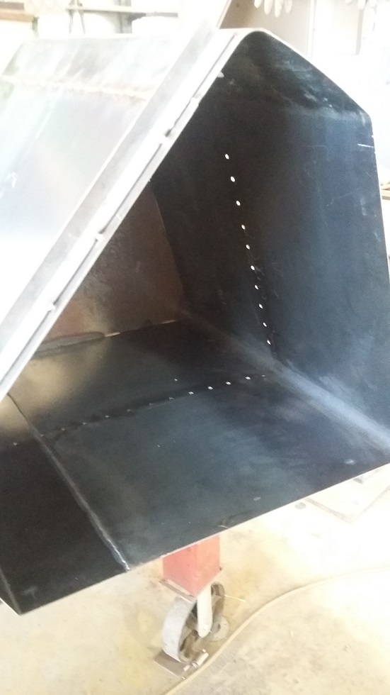

Happy New year to all. I trust everyone had a good one. I am back from a cruise around New Zealand and it certainly is a most beautiful country.
I am doing the fuel tanks as I want to close in the back to complete the hulls.

Quite a few angles to these tanks and they have a very solid baffle in there as well.
