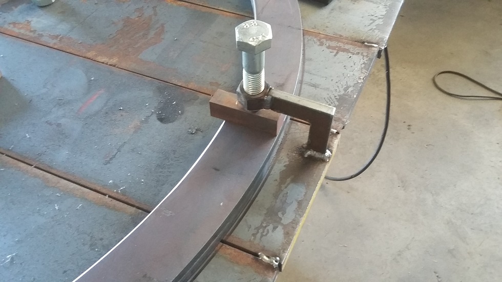

I am going to make the race in layer and weld them together as the profile is not something I can do in one piece but as I am able to cut all layers very accurate it will not be a problem as long as I manage the heat during the welding process. When I first saw the top of these tanks, I was amazed how thin the material was not knowing the profile of the turret ring and race as that is where it gets its strength from. The turret is almost as wide as the tank itself.
It really a very good design and a very interesting one to make as well. I had I price of $7k to make each race and a 2 month waiting time from China. Happy to make my own.
Colin, I wonder if you could rely on the bolts that hold the ring to the hull and not actually weld the layers together at all. The turret is not very heavy and the balls are hardly going to prise the layers apart. I am thinking that building the ring in layers should work pretty well. The running surface will need to be relatively smooth and the ends of the segments be aligned but there are enough balls that the surface loading will not require hardening of the running surface (though it would be nice). Actually WW2 proper tank turret rings were soft enough that there were instructions to move the turrets from time to time to prevent indentations forming.
Great work as always.

Dave, there are not that many bolts holding it down, 16 is what I can find and only 3/8 or possibly 7/16. It does have a geared traverse and you are definitely right another minefield on its own. I have a few ideas for that but cross that bridge in a week or so.

I have made a solid table top for temporary use of keeping my bearing surfaces flat. I have used some 20mm plate I had here so I can use it again when finished. I have a centre and a diameter finder and some instant clamps for keeping it all together while the process is complete and slow cooling. I think I can cut the internal gear on my plasma and that will be a fantastic saving and a quick process.
20180202_112438.jpg   20180202_112448.jpg   20180203_121855.jpg   20180203_121909.jpg   20180203_121936.jpg

Hi Bob, I have to weld two rings on top and the top one having a internal gear all round. Then I need to put the whole thing in my milling machine and cut a 3/4" grove the full distance around the top. The photos below show the first one welded and ground off and I had a prelim try at cutting gears on my plasma. I am quite happy with the result but I need to make time on the computer and draw a curved toothed ring for the last top section. There will be a bit of trial and error on that part I think. I am very happy with the result of the ring so far.
20180203_155353.jpg   20180203_155403.jpg   20180203_155422.jpg   20180203_155443.jpg
