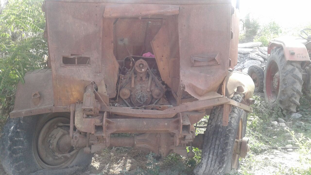

Experts kindly identify this truck.Its a Ford WOT 6 or 8 ?? What are the differences between these two models.This truck was auctioned by Indian Government 6 months ago.
Ford WOT6, 1942-1945, 4x4 3-ton, about 30000 built
Ford WOT8, 1941-1942, 4x4 1,5-ton, over 2500 built
http://www.armyvehicles.dk/fordwot6.htm
0598fb37-cf43-4c02-87a2-de29ccb8d6b0.jpg   5191c959-93ec-4cf9-8d97-70b7036fa82f.jpg   074414c3-6336-408b-8fa6-1c2c797e1c95.jpg   5e8877c0-f467-45b1-b90e-d754d5921304.jpg   008b54c4-def7-4e7d-ac13-bed1493788a7.jpg

IMHO it is WOT6 (long wheelbase, demountable cab, air scoops, front fenders).
Basically the differences are:
https://postimg.cc/MXrMb9M7
Although there are some WOT8s with WOT6 cab, are they produced so or are field mods isn't clear. So the wheelbase is the only sure ID.
HTH
Cheers!

Also the long vent in the cab roof above the windscreen on WOT 8. However I wonder how many of the cab differences are early vs late rather than WOT 6 vs 8 ?
I notice also that the WOT 6 in post #2 has sling rings / step rings on the front hubs whereas the WOT 8 doesn't.
Presumably the production of WOT 6 & 8 started at much the same time and most parts would have been common then but the 8 got dropped very quickly while the WOT 6 continued to be improved. I have no evidence of this but it seems logical.

The WOT6 and WOT8 were mechanically identical, both had the V8. the tread grips on top of front wings on the 3 tonner are fitted straight on, there the 30cwt WOT8 had a flat platform on top of the wing. No idea why there were all the differences on the cabs, but that is Fords for you.

Sling rings on hubs were introduced on several makes of trucks from 1943 on wards, Austin, Bedford, Ford and probably others. An indication of loading for shipping with the invasion plans I have always thought.

Exactly ! My point being that WOT 8 was discontinued before sling rings were introduced but that it is quite possible that there were early WOT 6 without them too, and also with features that are suggested as WOT 8 only.
I suggest that very early WOT 6 was just a LWB WOT 8 with stronger rear springs and very few other differences but that after WOT 8 production ceased, WOT 6 received various improvements. If so they SHOULD be listed in the parts lists...

Apart from the longer wheelbase, the most significant feature that differs WOT6 from WOT8 is the demountable top half of cab, with the two handles just under the windscreen and a cover stripe over the gap. WOT8 was produced between 1941 and 1942. The early cabs had the round cab ventilator covers whilst the very late models had the rectangular airflows just like the WOT6. The step rings on the front hubs were mounted on both WOT8 and WOT6. I have this on my early WOT8 which has the round airflows. I think the purpose was to get a step to make climbing up into the high cab easier. As these rings are not mounted on the rear hubs, their purpose would not be for lifting the vehicle up for ship loading.
In addition to the features mentioned by Richard, the WOT8 had a hydraulic spare wheel holder lift, whilst on WOT6 it was mechanical. Also the engine cover and dash set-up is different on WOT8, see below.
Hi Dusan,
Till recently I've also thought so because it is so in theory. But the life can ruin any good theory.
I'm sure you're familiar with one of these WOT8 pictures at least, if not with both:
Maybe they are field mods but this can't change the things.
That's why I wrote above the wheelbase is the only sure ID.

I am pretty sure these are WOT6s on both of your pictures. The first one is WOT6 "EVA" one of about 25 that came with the Czechoslovak Armoured Brigade Group to liberated Czechoslovakia in May/June 1945. On the internet it is wrongly described as WOT6. We have not found any file that would indicate that the WOT8s which the Czechoslovak army had in Great Britain crossed the channel to France after D-day+. All were swapped for other vehicles.
I am not familiar with the second photo but that would also be WOT6. It is just the angle of perspective that makes you think that is has a shorter wheelbase. But the devided cab with handles indicates it clearly, so do the fender pyramid stripe "steps".
Note that the large tank behind the cabin was mounted to both 8s and 6s.
