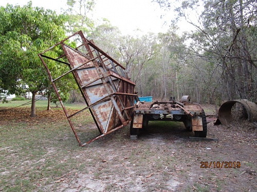

Hi all,
Thanks Danny, I see you are only a few hours north of me. Drop in sometime for a look if you wish.
I've been getting a few hours in to disassemble and remove the grain bin.
First cut off much of the sheeting and remove the augers.
Name:	LRT bin disassembly a 10 2019.JPG
Then when the easier-to-access stuff was done, we hooked a chain to it and tried to roll it off. But the lip of the I-beam caught on the lip of the trailer and its' rail hit the wheels and hung there 3" off the ground!!!
Name:	LRT bin disassembly b 10 2019.JPG
After a bit of crowbar work, it was safely on the ground where it needed to be. So then I could have a much better look at my trailer. It seems to have much of the original timber floor between the decks and there seems to be lots of dark gray paint on it. More pictures later.
Name:	LRT that's better 10 2019.JPG
I still have to cut up the bin to store/scrap the steel. Then I can deal with the wheels and axles problems.

Looks like a lucky find Sam.
I’m amazed that grain would be heavy enough to bend the stub axles.
They weren’t carting wet sand in it in the off season by chance?

Hi Jack,
A grain grower told me that bin was more like a 15 - 18 ton bin. Add the excessive offset of the rims on an axle designed for more-or-less zero offset, then take it for a drive loaded on a bouncy farm track, and I can believe the damage it has sustained.
Fortunately, I have recently purchased a large workshop press that I am sure will be up to the task!!!
Have a nice week.

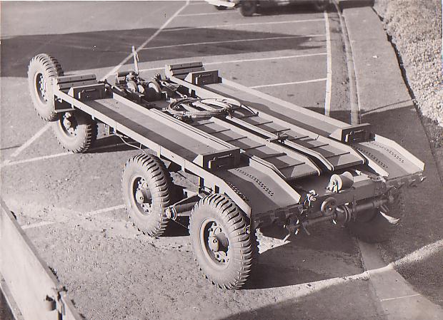

It looks like the ramps were held down on the deck by a t-bolt and clamp and held forward by turnbuckles.
Yes, the trailer it revealing itself more and more.
This thread might also help: http://www.mapleleafup.net/forums/sh...ad.php?t=19722

Old 01-11-19, 13:03
I downloaded these from Mr.Roo years ago. Thanks Cliff.
Name:	TRAILER 6WH 8TON A.jpg
ID:	109869 Click image for larger version
Name:	TRAILER 6WH 8TON B.jpg
ID:	109870 Click image for larger version
Name:	TRAILER 6WH 8TON C.jpg
ID:	109871 Click image for larger version
Name:	TRAILER 6WH 8TON D.jpg
Good Luck with it.
Regards Rick.

- there is the remains of one in a town near me, deck only. It is where I got the ramps from years ago;

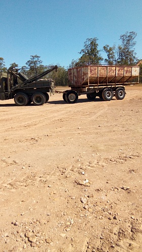

- I stumbled across an old remote area roadworks trailer riding on the rear suspension of a LRT in the Gulf country a decade ago. It is gone now, I'm told.

There is a British version in a museum somewhere, Adelaide or WA (or both?), which is visually similar, but very different underneath.
I also notice that many pictures show the LRT without the winch, fairleads and/or spare wheel bracket and other bits and pieces. So I'll be interested in information/pictures on these details. And I also notice two types of turnbuckle, probably 'as issued' and generic 'as available' at the time.

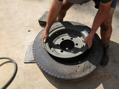

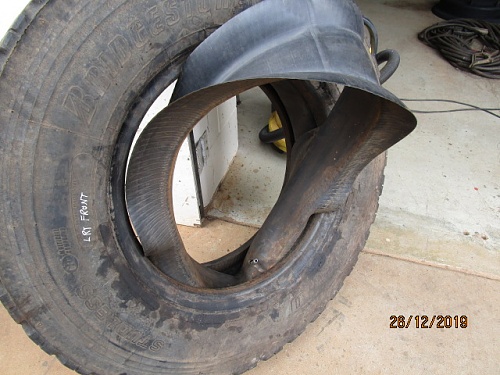

I've been playing with wheels. Managed to get some 7.50 x 18 tyres in good condition, so I have been cleaning up some rims and fitting them up. The original size tyre is 10.50 x 18 and is only available (in Australia) in an agricultural tyre which has limited road speed and a very poor wear rate on hard surfaces. So the 7.50 x 18's are going to have to do for now. The 16 ply tyres will go on the rear axles and the 14 ply will go on the front wheels.
So, after disassembling the wheels I purchased, I removed the tube/liner and cleaned them and re-assembled them. The picture below shows the fitting of the liner to the tyre following the fitting of the tube.
Name:	LRT Remove liner  18 inch rim 12 2019.JPG
The next problem which I did not anticipate was the mis-alignment of the studs. These I "massaged" with a large soft-faced hammer.
Name:	LRT 18 inch rim studs alignment 12 2019.JPG
Then drop the tyre onto the rim inner followed with the rim outer. . . .
