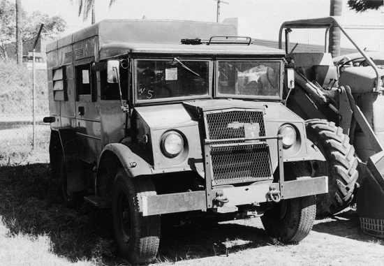

This one and the other one, a cut down signals van came from further away northwards
The cut down signals van (that I now have Grampa's crane on) was in the Brisbane City Council as BCC id is stamped into the tyres and may have been this one (pictured) used by the tramways dept.
However at this time I have no way of knowing.
Anyone have more details/ARN/history of this council van?
Name:	Blitz 1.jpg..jpg
But I digress from why the 6 point star would be stencilled under the bonnet of cab 62512?
Anyone else have any clues? rod
