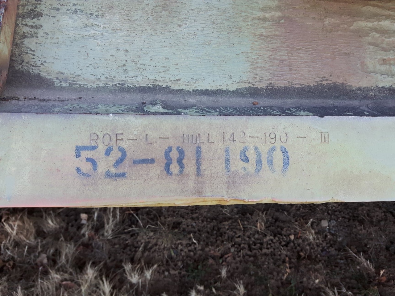

Here is a photo of the Centurion in question, with ROF serial numbers. I photographed this tank two years ago while visiting the former CFB Cornwallis, where it has sat for some time until now. There was a plaque attached to the left rear side skirt, if still there, it may state when this tank was "placed" at Cornwallis.

I have been looking over my list of Canadian CFRs and there was a Centurion Mk 5 53-81190 but I do not have its' particular WD No. The joy with CFRs is that even though the system is set up with the first two digits being the year and the last five being unique to a particular vehicle, I have not yet in over a decade of study seen the last five numbers being used twice at the same time. So for example I have not encountered say 52-81190 and a 53-81190 being used at the same time. Generally what happens is once a CFR is discontinued then the last five can then be reissued to another vehicle with a different year and I have seen this occur with quite a few of the older CFRs, such as those to the M37CDNs, which were reissued to newer model vehicles. Unfortunately once the number is reissued the data for the older vehicle is not retained which makes study and recording very difficult.
In the case of British manufactured AFVs, like the Ferret and the Centurion, Canada recorded the War Department Number as a form of serial number. The WD number consisted of two numbers/two letters/two numbers and I must admit am not sure how the British allocation worked for particular vehicle types although I do know that WD No. is used on the licence plates of British military vehicles. As I stated in an earlier post, the WD No. along with the CFR was stamped into a brass plaque which was mounted inside the hull of the AFV. Perhaps like the Ferret the CFR was also stamped somewhere on the hull.
My records correlating Centurion CFRs to WD Nos is very much a patchwork with more holes then patches but I can report that the nearest Centurion to 53-81190 in which I have most of the data; Centurion Mk 5 53-81185 was listed with a WD No. as 16 BA 14. Of course just to make the whole process more challenging, where I do have a consecutive series of CFRs with corresponding WD Nos., the WD Nos. are out of sequence.
I posted this tank's ROF serial number on another site to see if anyone might have been able to provide a rundown of its service history. While no one has, I was referred to the Tank Museum at Bovington. For a small fee it appears they will provide a vehicle history card for those who request it. The request page can be found here.
Anyone with a little spare cash will be able to see if the tank went to Korea or not, assuming it's the same tank.
Dan.

Originally Posted by Dan Martel View Post
I posted this tank's ROF serial number on another site to (...) I was referred to the Tank Museum at Bovington. For a small fee it appears they will provide a vehicle history card for those who request it.
Yes, once I see if there's any proper data plate inside this thing I'll be talking to Bovington...but I didn't have that link, so cheers.
The source of the Korea-thing initially was a communication from Borden to Cornwallis which reads:
“They [Borden] have researched the history and that particular Centurion was the only one [currently in Canada that was] in Korea”
That became a sound bite fragment which got picked up by one press outlet and reinterpreted into "the last Centurion in Canada" - which other press folks just quoted and ran with. Had we known in advance that the copy was going to read like that we would've corrected it before it spread, but it didn't work out that way, and once things get out into the media they take on a life of their own. No surprises there to any of us who've been interviewed and misquoted or quoted out of context before, or quoted in a jenga-like puzzle of reordered sound bites.
The 'stolen valour'/ hitching-a-ride thing from someone up there aways...really? Despite the fact CN's community spirit and generosity got it transported across the country - and Brent and Carrie Hill from Lumpy's Lowbed got it to our local Legion for Remembrance Day...there were still huge costs involved in craneloading at Cornwallis - transporting it to the railhead - craning it on to the flatcar...all of which was borne by Mr. Newby so at least *some* vets and other folks *West* of the Rockies would have a chance to see an example of something they'd otherwise have to book WestJet for. I don't really see a downside to that - but I notice throughout this thread that some folks are grasping for one regardless.
It's a lot easier just to ask the people involved some basic questions vs. some of the stuff in this thread, but...with some folks there seems to be this compulsion to get political over everything and take the Low Road. Not really sure who that serves. Certainly not the museum community. Certainly not the collector community. And certainly not the public.
