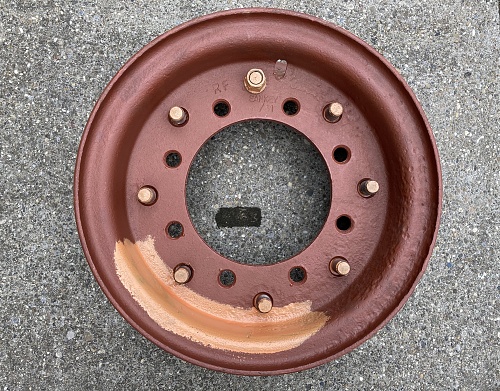

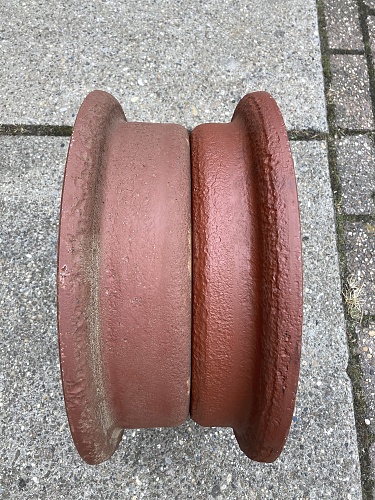

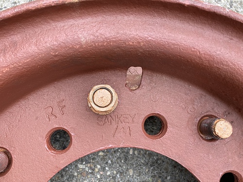

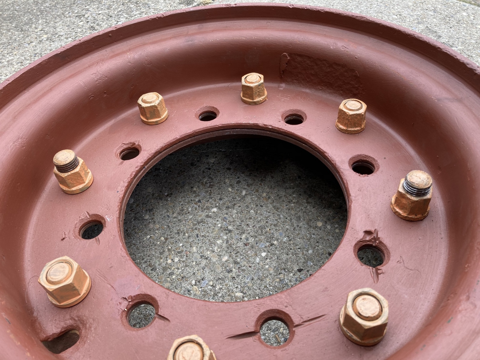

Default British made rim
British made rims have the valve stem opening to the right of the bolt. All eight bolts are the same length.
The example is marked "RF" and "6.00x16". It was made by Sankey and is dated "7/41".

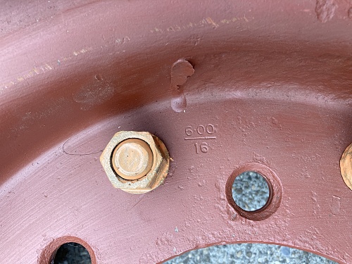

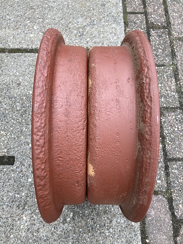

Old 27-06-20, 22:28
Default Canadian made rim
Canadian made rims have the valve stem opening to the left of the bolt. Two of the eight bolts are longer than the other six.
This example has no maker or date stamp, only "6.00 / 16".

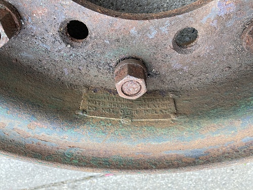

Old 27-06-20, 23:34
Default Instruction plate
Originally Posted by Owen Evans View Post
My Canadian rims have the attached instruction plate welded to them. Not present on my British rims (but they could have corroded away, of course).
Thanks for the addition, Owen. I have a British rim for sale which still has the instruction plate attached.

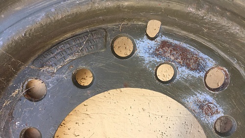

Old 28-06-20, 01:10
VMVC
Join Date: Jul 2012
Location: Victoria Australia
Posts: 869
Default 16" WD rims Ford and Chev difference
Hi Hanno,
Another difference I have noticed between Ford Kelsey and GM Canada rims is the GM rims have an embossed pattern around the outer rim just noticeable in the photo. Ford rims are smooth at that position.

This example has .....
Attachment 114791
..... Angle grinder cuts where the wheel nuts were cut off!
Not meaning to divert this thread, those cuts can be repaired to present a better finished rim before final painting.
While naturally a bead of weld will fill the grooves, the weld itself will require further grinding to clean it up flush and present a smooth lug nut seat. Some people might also have qualms about heat damage from the weld affecting the temper of the rim, and therefore it's structural soundness.
I have had great success with a metal filling epoxy called JB Weld. It can be shaped, sanded, or ground easily and binds securely to metal, so won't fall off in a slab years later. Readily painted with any automotive primer and paint system (ie Enamel or Acrylic). It doesn't just work on repairing grind marks, it also does a fantastic job on sandblasted rims that have hollows from rust pitting or gouges from kerb strikes. You'll have that rim looking like new again.

Old 28-06-20, 12:51
Default British rim instruction plate
Here's another variation of the instruction plate, have not seen this before.
This is a British rim, as it has the valve stem opening to the right of the bolt.

Old 28-06-20, 14:41
Default Embossed pattern
Thanks Jacques, I have never noticed that before (or did not recall Tony mentioning this back in 2006...). Nice detail!
