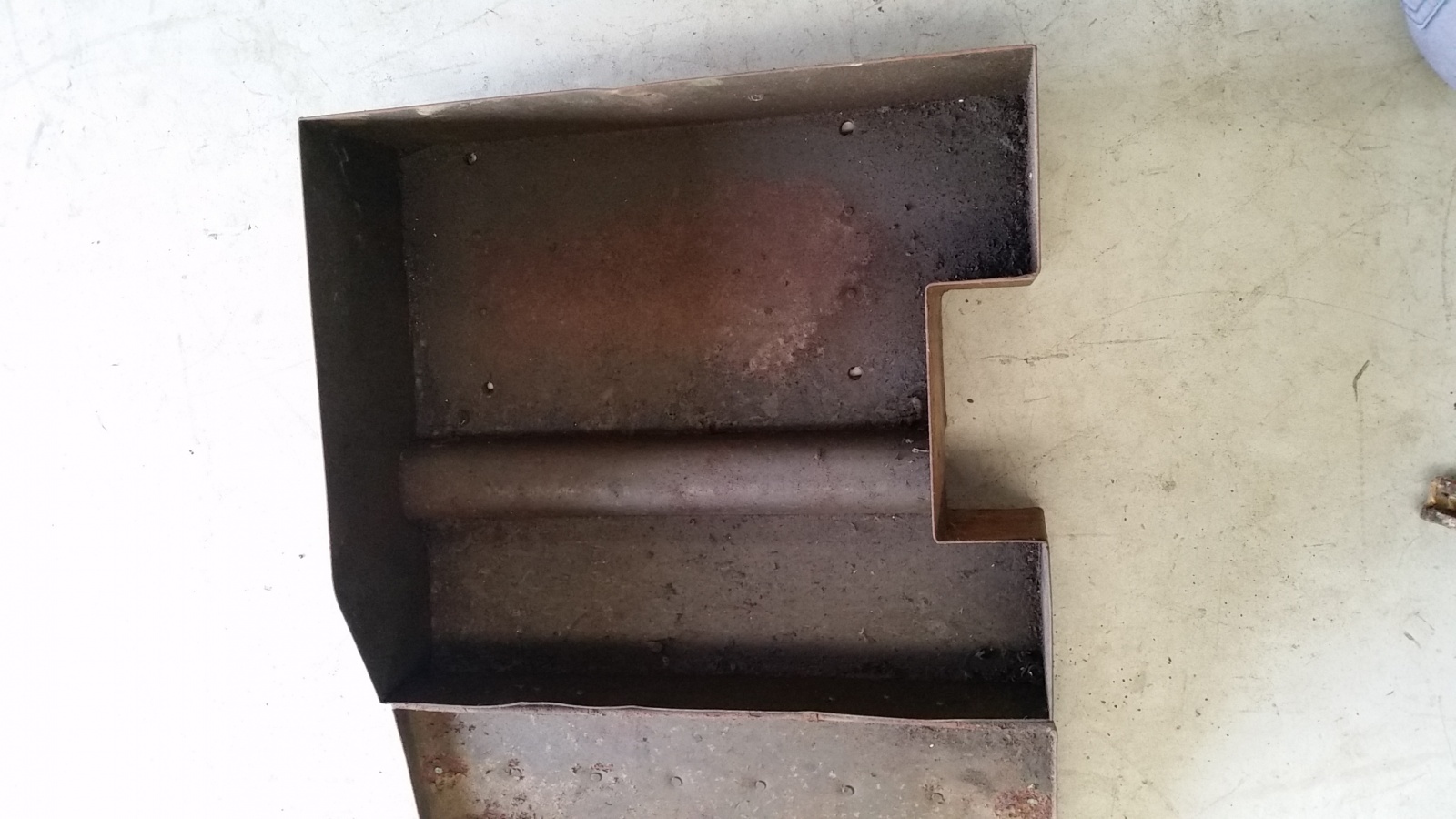

  #142
Old 24-08-21, 22:51
Israel Berko Israel Berko is offline
Join Date: Mar 2016
Location: Israel
Posts: 64
Default ctl 780 Ass'y
Does anyone have data of the CTL 780 part as a diagram / dimensions and drawing of the part?
Also the second photo the two rods covers of the driver and passenger parts A and B.

Old 25-08-21, 00:35
Your A is the tool box with the kneeling pad CTL 780 A. I have never seen that other cover other than that pic in the manual. I expect they didn't last long in service life.
  #144
Old 25-08-21, 06:00
Dave Good
Join Date: Dec 2003
Posts: 684
The B pic john Bizal reproduced some of them from my example and maybe he might still have some left.

  #146
Old 25-08-21, 06:30
Back when we were stripping parts and armour off carriers in Northern Ontario, we found several had the covers. Even the half a hull that was in the gravelpit at the edge of town had the cover. I believe one of those covers will be the one Dave has and John copied. Seems to me some or most of the carriers that were buried in the beach near Portage also had them.
John's copies had a small error on them where the cover would bolt to the floor to the right of the driver. It needs to be stepped to go over the small bellcrank plate if I recall. I discussed it with John and he mentioned that the area from the one he copied was a bit rusted there and it was hard to get the exact detail. It was easy to correct.

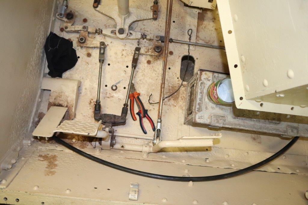

Old 25-08-21, 12:49
A couple of pictures.

Join Date: Jun 2011
Posts: 1,171
In the (1942 ?) Canadian “A” series Memorandum for Universal Carriers, units are instructed to remove the steering and brake controls cover, and dispose.
IMHO that was an excellent decision.
