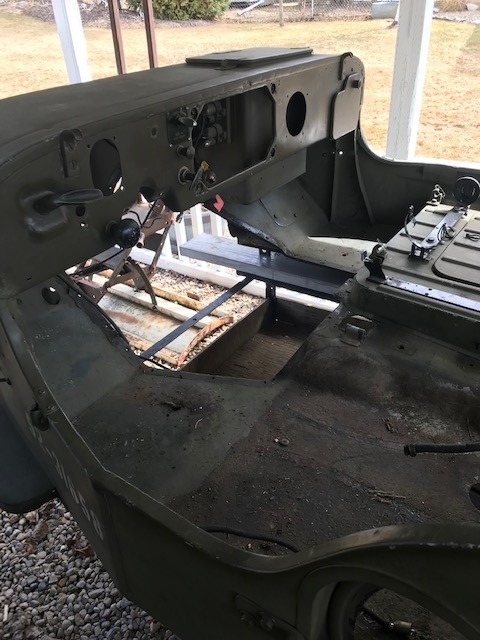

Took advantage of the nice weather to power wash and degrease the jeep tub in preparation for body and paint. What I didn't expect is for it to fall on my right foot. Luckily it was a glancing blow and not the full weight which I guess is around 300#. I don't think anything is broken as I can move around with minor discomfort, it's just swollen, even more this morning. I still might get an x-ray today to please the wife as my ears are bleeding from the nagging
And for the record there is only minor damage to the one tab under the tub that attaches to the frame, easy fix...tough old things they are!

Great advice Rob, thanks. I'll install the ground mod as I have some spare Douglas connectors and wiring.
Got the tub stripped down and only broke one footman loop screw and have to drill one stripped screw out. My original sandblaster guy is AWOL now so the hunt is on to find someone that is competent to blast sheet metal
