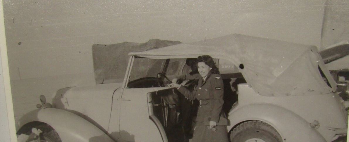

Does anyone know what model and year car this is? thanks

Humber Super Snipe open tourer built for British Army during WW2

very nice thanks. Do you know what size wheels it had?

With Richard having identified the car, I found some more information about it that mentions just about everything except for the wheel size. Scroll down through this thread accessed 8th of October 2022 from, https://www.imcdb.org/v116778.html.
Tyres fitted were 9.00-13 with 5 stud wheels, but not the same as other makes with the PCD of the studs. I restored a military staff car version some years ago and then found out about the variations of the 13 inch wheel stud patterns when searching for a set.

Were the studs 5 X 5.5?
This wheel
Scott,
Your photo is of an early Humber wheel which should have a hub cap, later ones had a sling ring for lifting on to ships, etc and no cap. They would have been introduced around 1943 on.
If you are using a Ford axle, I think the Humber wheels will not fit due to a differing PCD of the wheel studs.
