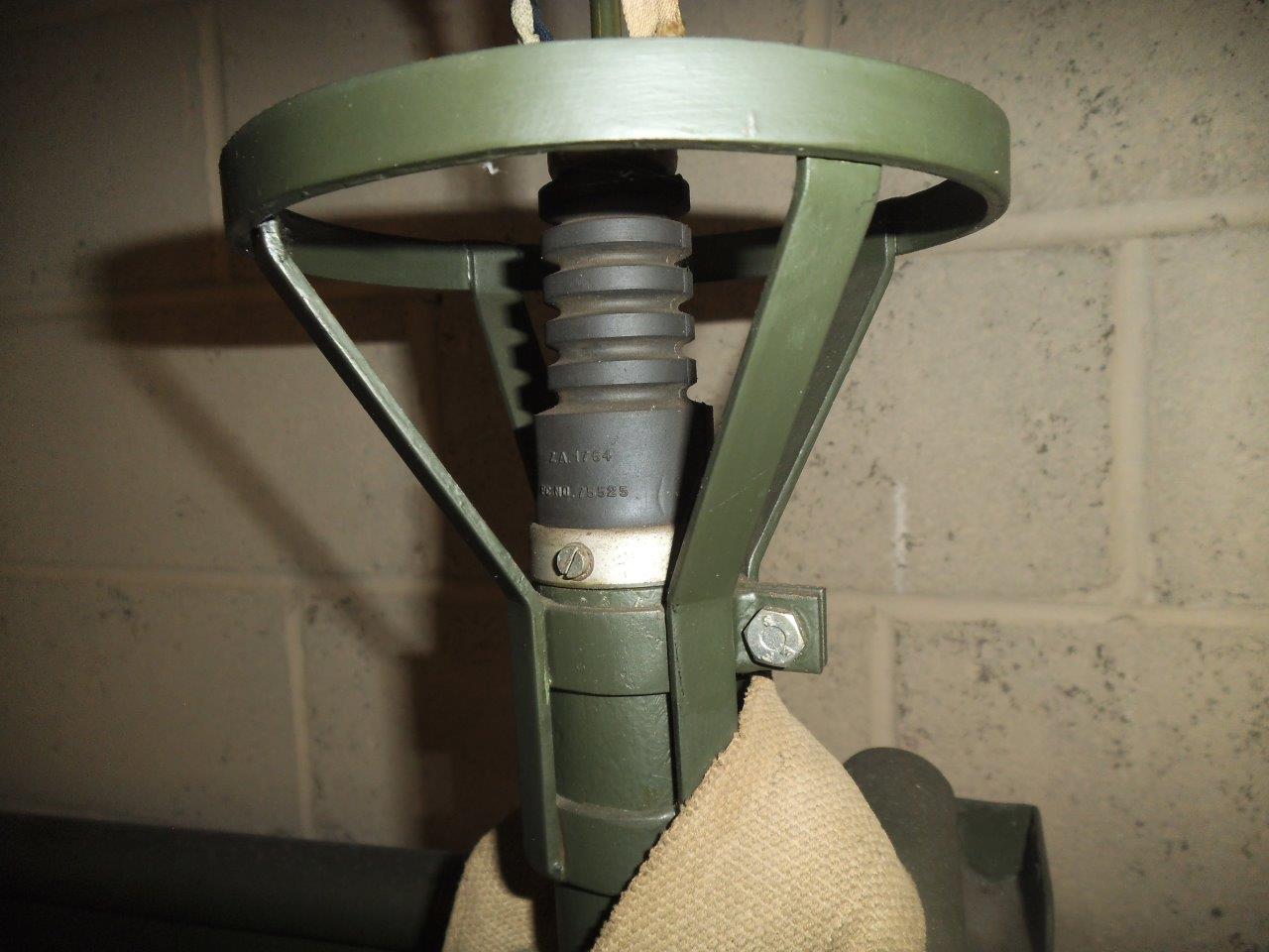

Can anybody help me with the dimensions of the B set antenna mount protective cage. I would like to replicate one for my carrier but would like to have proper measurements from an original one to go by.

I’m just curious about the circumference of the top round guard. I measured Gord’s and I know it’s 1/2 inch metal and I can figure out height and clamps from the photo but not sure how wide the diameter of the top ring should be made.

I just measured mine with a Vernier and it's 6". Ron
Old 18-03-25, 14:00
Posts: 567
I don't have one here to measure but ALL the real ones that I have seen are made from 1/2" x 1/8" black steel (ie. with slightly rounded edges) as in Ron's photos in post #7. I suspect that the one in post#1 is a repro as it looks to be made of 1/2" x 3/16" bar.

Thank you gentlemen. That’s what I needed to know! Now I’ll start fabricating. Stay tuned!
