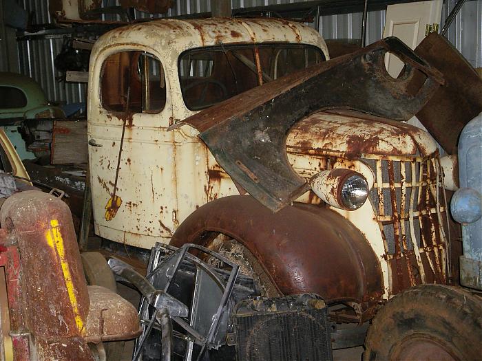

this is an australian holden bodied cab with the triple roof pressing
cab common through 36 to 38
This one is a 38 .This model is unique in its grille cowling with the forward protrusion near the top on the sides

Thanks Mike and Andrew.
The previous post pic, that's the beastie, same protrusions near the lights and very rounded side windows. Thanks.

congratulations
1938 then
In my opinion one of the best looking models
Pick it up if you can
Post a few pics too
originally should look something like this -except with a centre grille emblem and mould
