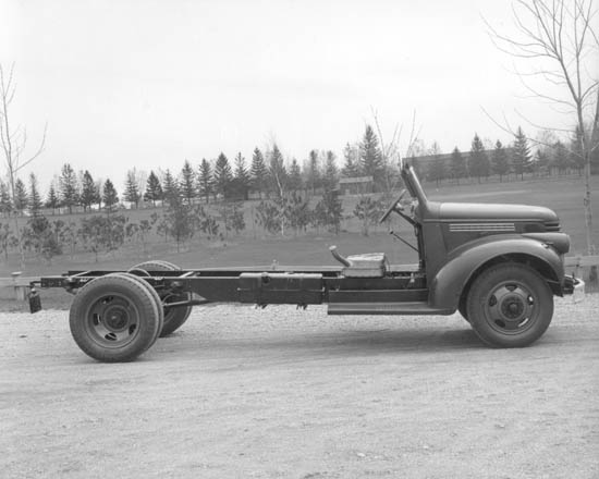

I wonder if anyone can help me please? I am looking for any photographs of the original Chevrolet 1533X2 30cwt trucks circa 1942 prior to conversion by the LRDG. I recently found this picture on the web, it purports to come from that excellent BBC series ‘The World at War’, episode 8.
Name:	Screenshot_2020-04-19 Photobucket albums hh245 Bilko_photo Chevoriginal jpg.jpg
http://i258.photobucket.com/albums/h...evoriginal.jpg
If it is pre-conversion truck then it clearly starts out life as an open cab truck. I originally thought that they were closed cab trucks that the LRDG modified by, amongst other things, cutting the roofs off in a similar way to the Chevy WB’s that they used. In the photograph below you can clearly see where the windscreen pillars/posts of this surviving LRDG WB have been cut off. However as far as I know you don’t see this on the 1533’s.
http://www.lrdg.de/v_wb3.jpg
My guess is, therefore, that the 1533's started out as open cab trucks. But that is only my guess. There are much more knowledgeable guys out there than me.
It would be great to hear from anyone who has photographs of the original 1533 trucks and also whether anyone can shed any light on the World at War image.
Thanks!

Tony the trucks you mention were flat cowl export models which were produced with only the front sheet metal and with out windscreen pillars. The bodies were built locally at whatever destination they arrived at. Fargo, which is the Chrysler Corp. export model truck were exported as flat faced cowl models as well. In New Zealand most of the Fargo, Ford and Chevrolet trucks/ panel vans were local bodies with wooden frames which looked the same as the all steel cab from a distance but was totally different.
The early model Chev you have pictured was a steel cab cut down but the YS model you show is an Indian Army model and they did a lot of canvas roof type vehicles including CMP's.
I have added 3 photos below. The first is a 1939 WB Chev flat faced cowl model with local Egyption built body on it the other two are Indian Army Chev's. Photos are off the net and I can't remember where from.
There is also a thread on this forum called I think "BOMBAY CHEV'S" which has a great deal of information and a few photos of the Canvas roofed flat cowl Indian Army vehicles.

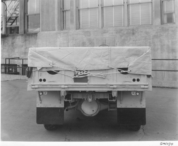

These pix off the Factory Photos CD should solve your dilemma.

If you could just indulge me a bit further, the truck that Cletrac posted photos of, is that the 'India pattern'?
Also, is this the version that the LRDG modified for their own use?
Finally, are there any shots of the cab interior/dash and is the 'factory photo CD' available to buy?

The India Pattern used a locally made box while the one in the pix I posted is Canadian made. This looks identical to the LRDG truck. There aren't any interior pix on the CD.
Check out this thread for the CD. I highly recommend it: http://www.mapleleafup.net/forums/showthread.php?t=9101
The surviving LRDG truck has had the windshield removed. It pivots on those two bolts at the top of the short posts. The posts weren't chopped, they were made like that. On some of the LRDG pix the windshield is in place.

If you look at the photos of the factory Chev you will see that it has no provision for the folding canvas cab roof whereas the 'Indian Pattern' trucks do. The Later 1533X2 LRDG trucks were made new in the factory to the LRDG's design so in effect were just another 'model' of new truck rather then trucks the LRDG modified for their own use. Mind you they were probably modified further by the troops that used them.
