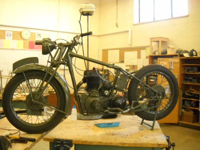

I need some grown-up help here....
where do I find bolts for this?
what bolts arwe they?
any copies of a parts manual?
On the up side - it does run....
Pictures tomorrow - maybe.

Fateners are Cycle thread (26TPI) with Whitworth heads (no A/F rubbish on Birminghams' finest). Some of the larger stuff (1/2" up) may be 20TPI. For generic fasteners try Namrick, otherwise Russell Motors in London or, as a last resort, Draganfly.

I've got the driver/operators manual, and a few catalogues from Russel and Dragon.
The big cry out for me is to locate a parts book that says what goes where, and how it's held on. Many holes are stripped and I may end up "bolting through" or tapping out to a modern size.
My personal approach is that you can do whatever you want, just don't mess it up for the next guy (or gal)
I started up the "THUMPMASTER 500" yesterday but it's skittish as a blushing bride. Sometimes it will , and sometimes it won't... you get the idea.
It must be alergic to gearoil as well. The pint I put in yesterday pretty much fell out overnight without even slowing down.
Does this mean I don't have to pull the drainplug to flush it?
thx

Charlie log on to the BSA WD M20 site that Grant posted a link too. Check out the restoration tips page, or post any enquiry on the forum and I promise you will get help. Ron
