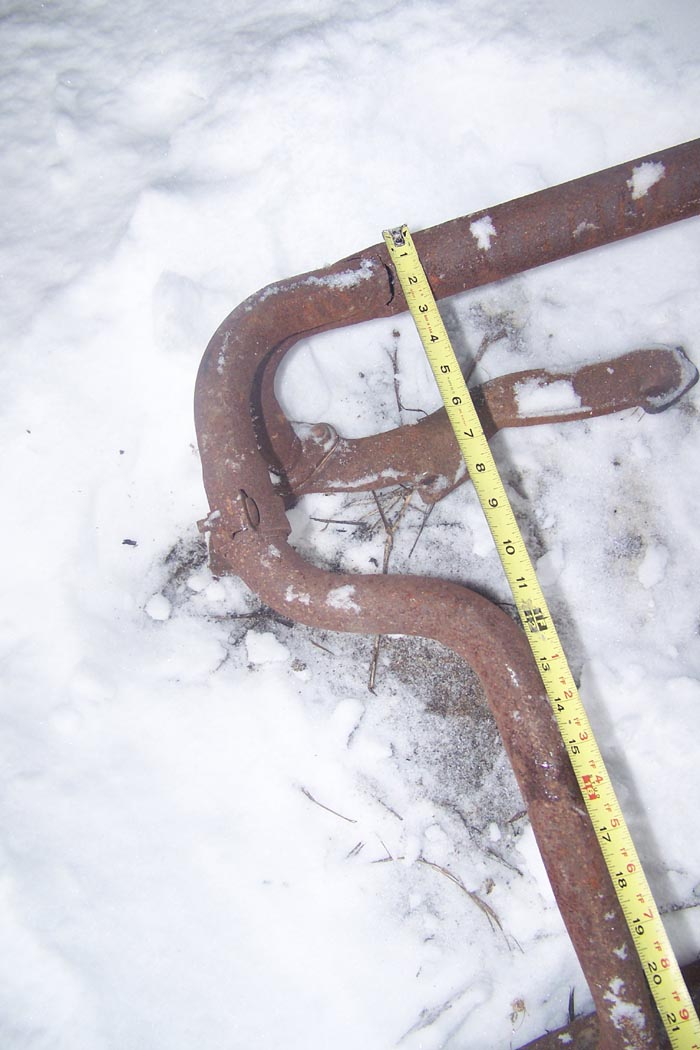

Here's some pics of an original setup.

Thanks for info so far.... but... the pics from Cletrac show, I think, that the crossover and "Y" are different than for civvy vehicles. Didn't the CMP's have a deeper sump/oil pan? Thus the crossover goes down deeper and the "Y" has a wider angle than those pictured in the various old Ford catalogues. So, all flat heads the same? Maybe not?

Hello David,
Here's a picture that may help.
Unfortunately it is only one dimensional but I tipped it over to try to give you an idea how it looks.
Note that the outlets of the manifolds are on an angle so the pipes clear the chassis rails.
It is from a book that Lynn Eades loaned me to read last night.
If you need a larger pic I can email it to you.

Robin - yours is the best solution for me, I think. If I took my truck with exhaust system all in place, though close to failing, into his shop and left it with him he should be in a good position to replicate? Once I get a quote, if others want systems to match, speak up! Good for Cab 11/12 - not sure if Cab 13 is the same. Shipping would obviously be an issue outside of Ontario.
I did contact Red's Headers in California. They dont have any NOS and the only system they have for right hand drive is a multi-pipe header as opposed to a cast manifold - that would be fine except that it protrudes quite a lot from the block and I'm sure it would foul the footwell walls in the cab 11/12.
I'm pretty sure that the deep sump of the CMP V8 is special and that the civvy systems out of Mac's etc. would not work (wrong cross-over, wrong V-joint angle). Plus the different manifold detail. I'm surprised that this hasn't come up as an issue before now. Was the manifold changed for the CMP just to clear the tight space in the leg wells?
Thanks again all, and the drawings/photos.
