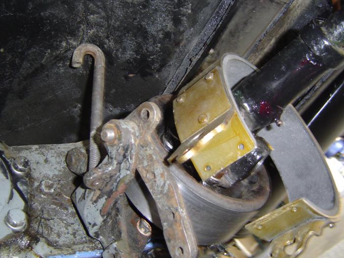

Ever started a job and wished you should have left well enough alone. Well I started a job feel like that now.
I decided I would make my 1942 Willys Jeep a bit safer by replacing the existing park handbrake and fit new transmission brake linings. I purchased a new inner and outer handbrake cable and new bonded linings fitted to the transmission brake. And that was when the problems started.
After first feeling pleased with myself, I strarted to reinstal the transmission brake. There is a frustrating bolt with a hooked end which after an hour of fiddling and colourful languageI, just could not put back into place. There is just not enough room to move as the top of the bolt is restricted by the jeep body.
I am sure there are restorers out there that have also come up against this problem. I can now see I have only a couple of options left.
1. Raise the body to allow movement to drop the bolt into place.
2. Cut a 2 inch (50cm) square hole in the floor and drop the bolt into place, then cover the hole with a cover plate. ( for future use. )
3. Appeal to you guys for an easy solution????
I have attached a couple of photos indicating my problem.
Little Jo

Can you let the cross member under the trans down? (lower the whole back end of the motor/g-box/ transfer case etc)

possible to take a little of the bolt? when mine is adjusted up there is a lot of thread protruding? maybe silly but if it came out it should be able to go back in although sometimes there has to be some choice words good luck

Stupid question but how did you take that bolt out in the first place? Why not just do the opposite.

Tony,
I presume you removed the whole thing as a unit to refurbish it with the bolt hanging there and forgot to put the bolt back when you bolted it all up again.
I assume you tried putting the hook upside down into the bottom of the hole then running the bolt in a semi circle until it stands upright. You might need to widen the hole a little to get it around the corner.
Best thing to do and only about 20 minute's work is to drop the universal. Unbolt the output shaft flange and pull the brake bracket unit off, drop the bolt in and put it all back.
I wouldn't do that but I am a bit rough. The hole is not critical with the hook so I would just get a drill of the bolt diameter and run through the hole and elongate it at the same angle you have the bolt jamming. By the looks of your photo it will not take much. You could also try a bar beside the bolt on the floor to prise it up, not so much that you permanantly bend the floor (but you could tap the lump back down again if you did). It is amazing how much movement you will get and as I said it does not look like you will need much.
Last choice is to just get another bolt, threaded a both ends and slide it up fom the bottom and put a lock nut and heavy washer on it in place of the hook.
The whole exercise is a basic waste of time because only one jeep in a thousand has a handbrake that could be described as working effectively. Your new modern brake linings are likely to be much too hard to work properly, despite perfect mechanical operation, anyway.
Keep at it you will get it back together.

I would like to thank, Lynn, Cameron,Mike, Jordan and Lang for their advice and idea's regarding to my "Transmission Brake" fitting problem. I had a good look at all the suggestions, then sat back had a good look at the problem and then solved it.
I made a simple surgical cut approx. 50mm x 20mm in the floor and then dropped the curved hooked bolt straight through, put the two springs on as the bolt came down and problem solved. The whole operation to put the brake back together, including the cutting out, took less then half an hour. No agro and no neighbours complaints about colourful language. I made a cover for the hole for any future use.
Thanks again guys for your input.

I think you are correct. I spent a long time on my back under the Jeep trying to put the transmission brake back together. But after a lot of frustration I gave up and put the problem to MLU members.
Their answers got me thinking and I solved my problem from a frustration into an easy job to fix. I can't understand why the original guys building the Jeep did not add another small inspection point take make the replacement of the hooked bolt easier to work on.
I used a long screw driver and pushed it from the bottom up through the holes to the floor and marked the spot directly in line with the holes that would take the bolt.
I then drilled a pilot hole from underneath to mark the exact spot. I then drilled a large hole from the top to take my electric jigsaw and cut the hole.
The hooked bolt just dropped through into place, I pulled the bolt upwards and placed the spring on the bolt lowered it a bit, put on the second spring and dropped the bolt through the last hole and put on the nut. so easy.
I then cut out a small cover and screwed it over the hole and painted it.
The transmission brake regularly needs to be removed, cleaned and lining replaced so why not make it easy to work on. I hope this will help others out there in MLU land.

Originally Posted by TCLARK View Post
Hi
I would first just put a pry bar in the best place and pull down on the tranny while you align the j bolt . looks like you only
need a 1/4 inch
Terry
Hi Terry
Mate, I needed more like one inch so the hole in the floor was a good option, so easy and will not be a pproblem if I have to get to it again in the future.
Tony
Little Jo
