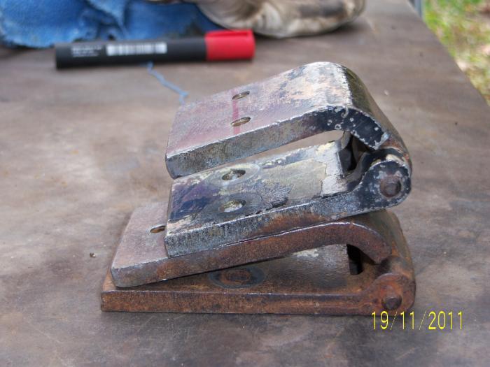

Mother Nature is playing games. This morning the mercury only went down to 2 oC and by noon, it was up to 10 oC, making for excellent working weather at the barn.
My morning was spent with my Bronco hinges. After a careful measuring, I cut off the excess length from both sides of the hinge. Once this was done the MIG welder was put to use to fill in the original holes in the hinges. Bob arrived just after the first hinge got shortened and he supervised the welding procedures.
Grant made his appearance shortly after and got busy inventorying his latest treasure trove - the high school CMP. Bob headed off to cut some more logs for the coming winter, and I helped Grant off-load the truck.
At noon we piled into Bob's Ford for lunch in Rockland. Bob decided that we three grubby types should sit down for a nice breakfast meal, so he found us a Bistro to eat at no less. We are used to folks staring at us, but today was different - I guess we didn't fit the profile of the Bistro's regular patrons... We sat in the back of the restaurant and chatted with a nice lady sitting at the next table, who turned out to be one of the co-owners. She was very nice and her staff were very friendly - even with Bob's teasing and joking.
On the way back to Hammond we discussed the weather situation, and surmised that what we don't get in November, we will surely get in December to April. In any case, the weather was fantastic. Back at the barn, Bob mounted the winter tires on his truck and changed its oil. Grant continued to catelogue his newly acquired parts, and I decided to rescue a set of HUP rear fenders from the body sitting on pallets in the big field.
Photos:
1 - Comparison - original (long) modified configurations - top view
2 - Comparison - side view
3 - Before shot
4 - After shot - prior to dressing
5 - Prepped for plugging the original holes

Once back at the barn we test fit the Bronco hinges to the HUP rear door. After marking hole locations, I drilled out the door side of the hinges. A quick session with the tap and the hinges were ready for mounting. The door was fitted to the rear opening and looked good until we tried to open and close it again. The bottom of the door was binding on the door frame. The lower hinge was the cause of the problem – its bushings looked like they were worn. So, Bob, Grant and I had a hinge BBQ trying to get the hinge pin out. Even after repeated heatings and hits with a drift, the pin remained in place. I decided that the hinge would soak in oil for a few days before we tried again.

Photos:
1 - We live a sheltered life at the barn - with lots of snow
2 - Bronco hinge being prepared for their new life as HUP hinges
3 - Test fit - rear door of the HUP
4 - Bob exiting his storage container - a spectator event
5 - The trucks in the back 40
last ride 004.jpg   last ride 007.jpg   last ride 005.jpg   last ride 008.jpg   last ride 009.jpg
