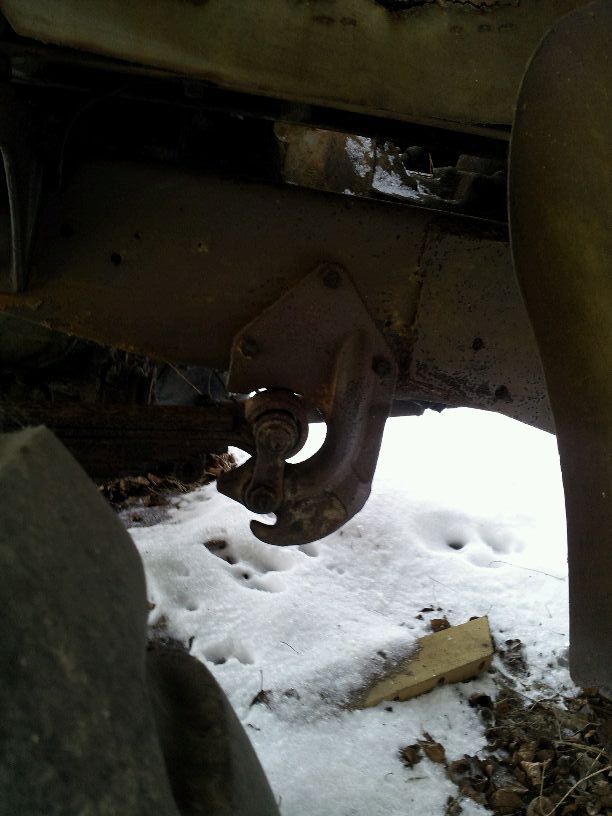

Here's the old girl (future project) 1943 Cab 13. The front spring bracket is different then yours. It has the extra hook on the bottom. Has anybody have any ideas why?
That is a very late production modification, I've only seen a couple like that here in Australia. I would imagine it would have something to do with anchoring a vehicle either for shipping or winching.
Does yours also have a different to standard gearbox cross member? One of those I saw with that type of spring hangar also had a F15 type cross member rather than the one where the gearbox bolts into it.

Thanks for the info. When I get home tonight I'll check and see if I have any photos. If not when the snow melts a little I'll get in and crawl under her.
Keith, I'm certain it's for winching, I distinctly recall seeing a diagram when we were kids, showing the use of scotches on a Cab 13 FAT. A chain (or cable) is attached to the scotch plate under the rear wheel and hooked onto the spring hanger, anchoring the vehicle for winching forwards. A similar arrangement was shown for winching rearwards, with the scotch plate under the front wheel, but I can't remember where the other end of the cable was hooked onto.
I always thought it was rather clever - the scotch plate has a "spade" underneath, which is forced into the ground as the vehicle is driven over it until the chain is taut.
As you say Keith it must have been a very late mod, because they're extremely rare to find. Here's one on a wrecked chassis I came across a while back.

...are illustration of how the scotches where tied to the truck in a fashion that allowed the wheels to be dragged over than held in place by the chain... it also shows where they were tied bu that may have been only for CGT...
I must admit I have never seen that extra hook on the front spring hanger.
Phil Waterman has a set of scotches and may actually have used them with his C60 cab 12 w/w.
There was a guy in Ontario, wine country, that had a whole bunch of wooden crates..... 4 scotches to a crate..... lucky to get a few before they went to the scrap heap as no else wanted them.
The hooks are for winching. Page 31in driver's handbook for chevrolet 1945 describes the scotching methods. My father in law said they worked well until the winching became dificult and if you didn't stop in time you snaped the U bolts on the scotched axle.
Perhaps that's why they introduced the hooked spring hanger. All the force is taken by the chain, there's no force whatsoever on the axle.

First I don't think the hook incorporated into the spring shackle was intended for use with the winch or winch scotches it is to lightly built. The U attachments for the scotches are much much heavier 3/4 to 1" diameter and they need to be.
I've attached the scotches drawing from the hand book as well as some pictures of the scotches on my truck. The pictures with the cables were taken when I was getting the correct length. Since then I've had heavy cable with loops made. Strangely because of the placement of the frame hooks the cable chain combo need to be different lengths depending on you are put them under front or rear wheels.
I've used the winch and scotches a lot for pulling very large trees up hill. The winch unit is amazingly power full and deserves respect. When you put the scotches down on the ground and hook them to the frame hooks and move the truck wheels up on them and then start pulling, because of the scotch angles they dig right into the ground until flush.
Yes, this is similar to the FAT diagram I recall, although not quite as detailed. Note low position of front cable attachment point - well below the chassis rail, in the vicinity of the spring hanger. This is necessary to avoid fouling the step brackets, petrol tank and brackets (esp. longer FAT petrol tank), and battery box on RHS. This can be demonstrated by running a string line from under the rear wheel to ANY point on the chassis rail itself where a hook might be mounted. It may just be possible on the LHS of 60S and 60L CMPs, but definitely not possible on the RHS. I'm left to conclude that winching forward with scotches was not possible before the hooked spring hanger mod. Any thoughts....?
As Phil says the hook is not large in cross-section, being merely an extension of the ribbed reinforcement part of the spring hanger, which is barely 3/8" thick. However it's of considerable depth along the line of force, and a thick stiffener pad has been added in the casting. In order to fail it would have to shear through a large area of metal, something along the lines shown in pic 5 perhaps.
There would of course be a component of sideways force, since the scotch plates are outboard of the spring hangers, and this would be greatest with the FAT, due to the greater angle resulting from SWB. All in all though I reckon it would be plenty strong enough for a CMP winch, which are only rated at 7000 lbs. However I guess we'll never know, unless perhaps Ian will be kind enough to test his to destruction for us!
