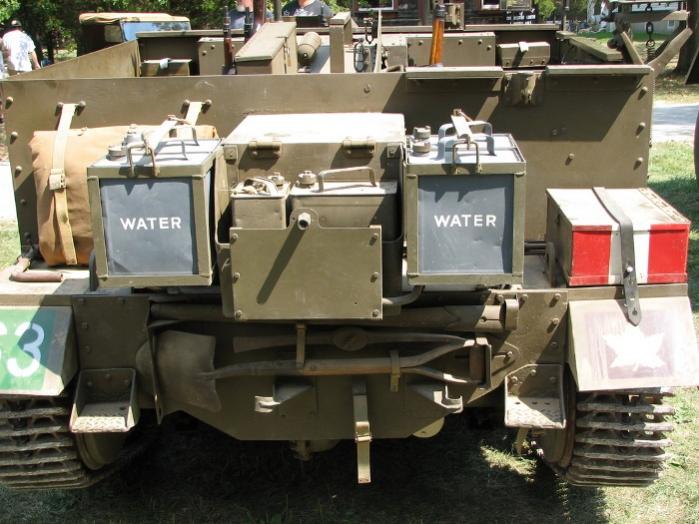

Originally Posted by Jim Burrill View Post
I Have that same "desert stowage" on my carrier project. Happy to take measurements if anyone wants to try to make a copy.
Jim, the water bins on your carrier led to at least one reproduction set!! Here's the ones I made using yours as a pattern. They are fussy to reproduce with lots of different sized metal stock (all available luckily) and alignment of the supporting brackets. Then you have to go out and find four of those "$300" water cans.

Bruce, I would be more than happy to pay you to make another set! I am not a welder and I have seen your brilliant
work! I don't think many could do as good.
Are you game??
Are you game??
Jim
But you have originals!!! They might need a little straitening but from what I recall are well worth fixing. Still, if you want me to make you a set, I'd be OK with that (small payment for the great favours you've done for me in the past) or restore yours for you.
