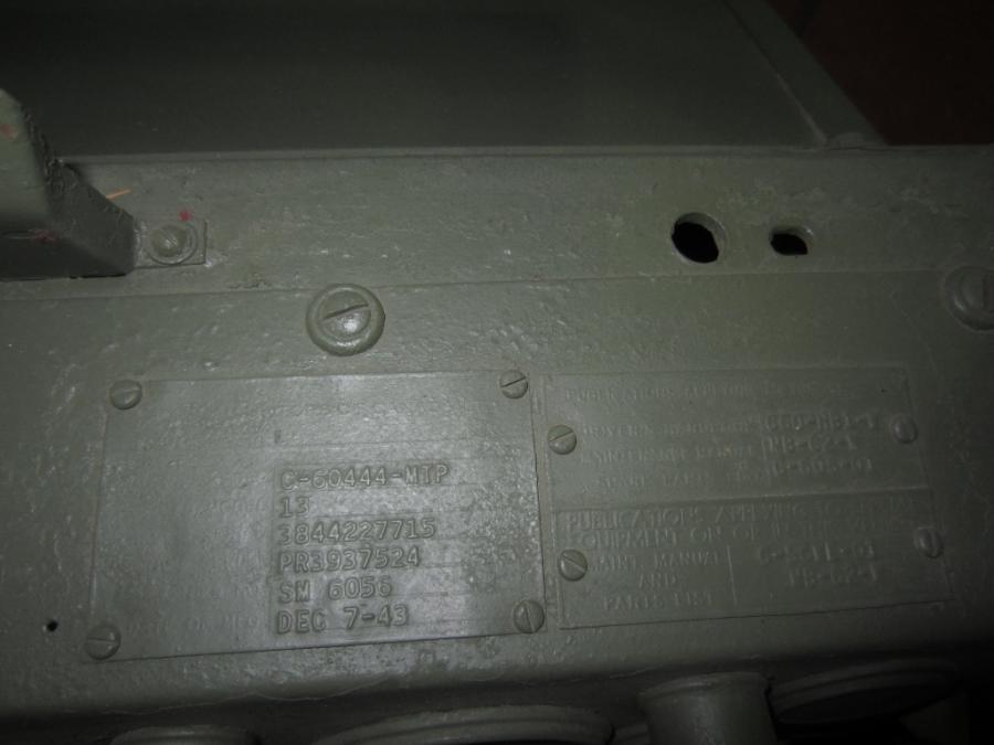

Default Cab plates and
Originally Posted by Hendrik van Oorspronk View Post
Here the other plates, if you look good you can see on the back of te plate the contact no. is changed from LV 1514 to SM 6056, is there any information about the LV 1514 contract?
Hendrik
Thanks again for posting these Hendrik.
When I went to photograph the REME Museum example a couple of weeks ago, also took these shots of its cab plates.
I see manual MB-C2-W is also on your plates but what is C-SCWE-01? A special for this vehicle ?

C-SCWE-01 is the Chevrolet Special Cold Weather Equipment parts list.
The following is a guess, but I think MB-C2-W is the normal MB-C2 maintenance manual with a supplement added for the cold weather equipment.

cordenj's Avatar
cordenj cordenj is offline
Join Date: Mar 2009
Location: Surrey UK
Posts: 169
Thanks Grant.
I was hoping one of them might refer to a manual for the wrecking kit and extra winches; but yes the REME Wrecker has extra cold weather equipment including what look like ducts by the front screens. To stop icing?

Its interesting that your wrecker and the one on the REME Museum are both from contract SM6056 but their dates of manufacture are 10 months apart. And mine is said to have been built in July 1943.
John.
1944 Chevrolet C8a HUP ZL-2
  #58
Old 31-01-15, 05:11
Posts: 275
Mine is even manufactured before the contract! It was first build for an other contract as a brkd 4 wrecker. I saw it when I removed the data plates, the old contract number and the 4 were hammered flat and stamped again in the plate as a 5 and with the contract SM 6056.
There are also several points where you can see that the winterization kit (the difference between the brkd 4 and 5) is added later to the truck.
Hendrik
