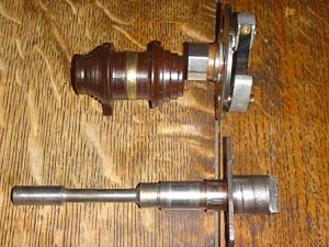

An update on the running problems: the distributor shaft was quite badly bent. It had 0.010" runout at the cam. Since the points gap is only 0.014-0.016" this seriously messed up the dwell and timing with big changes on a cylinder-to-cylinder basis as the shaft did a full rotation. The points being set too wide didn't help.
With a good, used shaft with 0.002" runout, and the points set at 0.015", dwell was right on the money and she's purring now.
Malcolm

When you say "distributor shaft" I take it you are talking about an 8BA engine with the distributor up top? Seems like it would take a lot of force to bend the shaft on either a crab or a divers helmet distributor mounted on the front of the engine.
No, this is a divers helmet distributor. And it doesn't take much force at all to bend it when all the parts are stripped off. I chucked the small end in a lathe and measured 0.060" runout at the journal on the other end. It only took a few taps with a soft hammer to get it straight to within 0.002". It's pretty spindly in the middle as you can see but I was surprised how easy it was to straighten. I cleaned the shaft up thinking maybe it was cracked but I couldn't see any.
Some rough handling would have bent it easily.
I bet the last person to set the points must have struggled.
Malcolm

I think somewhere back there Malcolm confirmed it was a divers helmet type.
How to bend a shaft in one of those, I don't know.
As it was the centre cylinders and one half of the firing order rotation, I think I was headed in the right direction as far as a misfire goes, but can't see really why it had matching low compressions, when comp test pointed toward valves.
Good news that it is sorted!

Lynn, I should have got into the ignition problem in a separate thread to avoid confusion as it was a totally separate problem. The low compression hasn't gone away!
That shaft wouldn't bend in service but throwing it in a box and then throwing other parts on top of it would bend it easily, based on how easily I straightened it.
Malcolm

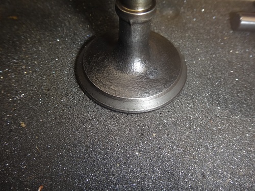

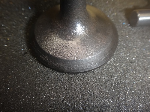

An update: due to the low compression test pressures reported at the beginning of this thread, we just pulled the engine to find the cause. I've only got the heads and intake manifold off so far, but checking each valve when fully open, I can see damage to the exhaust valve seats of the 4 low pressure cylinders. That seems to be the culprit. The other exhaust valve seats look ok, so I'm not sure why these particular seats went bad. Tappet clearance too tight and holding the valves off the seat perhaps?
The cylinders are 0.015" over and a bore gauge check of the bores just above the pistons at BDC and at the TDC wear "ridge" shows wear in the 0.002 to 0.003" range for all cylinders, so acceptable, IMO. But even the 4 "good" cylinders only had 85 to 95 psi results instead of 110 psi, so I think the bores need honed and new rings installed.
The valley shows a depressing amount of sludge on all surfaces. And the oil pan has a good layer of black sludge on the bottom. We use a 15W40 diesel oil in most of our vehicles. This is a high detergent oil and I suspect it is bad news in this type of application as the detergent dissolves the stable sludge deposits and circulates it around the engine. We should be using a non-detergent oil on these old engines.
I also found a water pump with the bearings almost seized, front crank seal rope packing installed so tight, it had burnt the paint on the timing cover, causing a severely scored front pulley sleeve, and a crack in the block around the rear boss for the oil cooler supply, due to overtightening the fitting. I'm not sure how to repair that. All in all, a typical 75 year old engine.

I've got 9 valve/guide assemblies out and two pistons so far. Everything looks in good condition.
Malcolm

Thanks for the good info, Lynn. I'll check out what pistons and cylinder heads I have.
But I found something else interesting. I only managed to get one exhaust valve/guide assembly out. (The others are stuck in the block, apparently a common problem with flathead Fords.) Looking at the seats with the valves fully open, I flagged this exhaust valve as OK. (It's on one of the "good" cylinders.) But check out the photo taken after I cleaned it up. It's far from OK. It's blackened and pitted. Compare it to the photo of a good intake valve face. I'm beginning to think the whole low compression issue is down to bad exhaust valves.
If penetrant doesnt loosen up the stuck valves, I'll have to make up the c-clamp tool to get them out.
Malcolm

I finally got the last 2 exhaust valves out of the block. What a pain they were. The problem is the early style V8's have mushroom-tip valves. You can see this in the photo below. The two parts below the valve are the split guide. So the guide halves are fitted on the valve stem with the larger end next to the valve head, the spring is installed on the narrow end of the guide, and the smaller horseshoe shaped retainer fits over the mushroom part of the stem to retain the compressed spring.
The lifter/tappet, just to the right of the valve, is fitted into its block bore just above the camshaft.
The whole valve assembly is then fitted into the block from the top side. The guide is a snug fit in a bore just below the valve seat. The guide is then pulled down into the lifter valley against spring pressure and the larger horseshoe shaped retainer is fitted into the narrow groove in the guide. When released, the spring pushes the guide and the retainer back up into its bore. The second photo shows the installed valve assembly, upside down.
The problem is that the guide can seize into its bore after many years of service, or after many years of non-service for that matter. And you have to get the guide out to get the valve out because of that mushroom tip. Damn you, Henry Ford. I couldn't free up two of the guides despite making a c-clamp tool to press them out. I ended up removing the smaller retainer, which releases the spring, pulling the valve head out as far above the block as it would go, cutting the valve head off, driving the now-accessible guide halves down into its bore with a brass punch, cleaning off the rust/varnish build-up at the top of the guide bore, slathering on WD40, and finally getting the guides out of their bores.
So the 8 intake valves came out easily. Of the remaining 8 exhaust valves, 2 came out with the c-clamp tool, 4 came out with the c-clamp and some serious prying., and the last 2 needed the drastic treatment.
If your planning on rebuilding a Carrier engine, put a few hours by for this job.
Malcolm
PS torque on connecting rods is 35-40 ft-lb.
