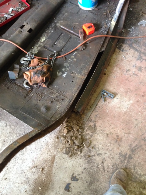

These photos show the rear floor layout of the Tilly showing where the sill is chopped and the B pillar located, and the main mounting point for the rear body sides. All that has to be relocated or fabricated onto the car chassis.

The floor panel was removed by drilling out all the spotwelds. It is pretty solid still with one small area rusted through. The rear section is badly rusted and will need to be replaced. Chris wants to tow a trailer so I will replace the rear section with some heavier 3mm sheet re-enforced so I can incorporate a stronger section to mount a tow bar.
