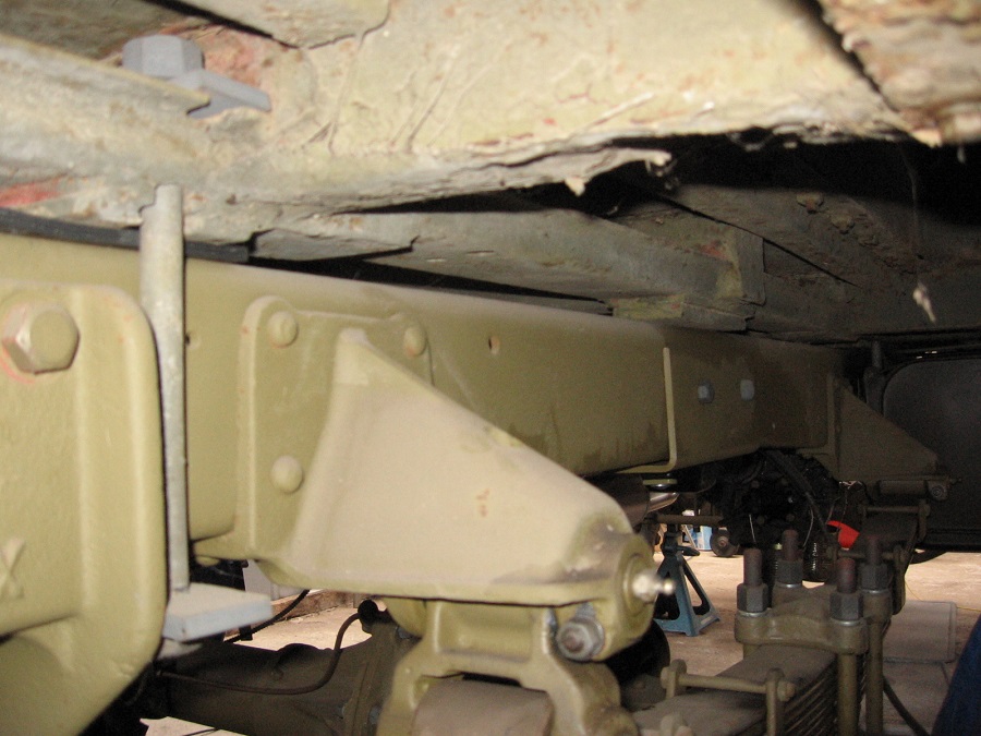

Picture under my body.
Robert Pearce.

Thanks for the photo looks like the sills are only about 1" thick which is the same size that my mates Ford stake side body sits on.
Now if I can only find why someone went to the trouble to recess those channels into the transverse cross members I would be really happy. If not original, recessing them seems like a lot of work for no apparent reason.
Bet as sure as I would cut out those channels on mine and weld my other channels on top of those cross members someone would find that there was a wartime modification to lower the floor, or the center of gravity, or some other reason.
Think I'll wait and won't do anything too hasty, not that I do it the best of times!

On another note: I got my chain box lids folded last week. After waiting 9 months for another firm to do the job I told them on the fourth call/visit to forget it. I am fairly patient but not that patient. Found a small firm in another town and got them made overnight. Just have to make the slots for the padlock then take it back to get him to spot weld the piano hinges onto the lids and boxes.
Thanks Ian Fawbert for your kind help with photos and dimensions of an original many months ago.

Thanks for your comments. Actually I only had the lids fabricated. The boxes were originals but highly banged up as per the attached "before" photo. they also had lots of extraneous holes drilled in them over the years but at least the steel was still solid. Still, I wanted to save them if at all possible even though I had drawn up plans to make replicas if straightening wasn't successful.
I welded the holes marked "X" shut then took the boxes to my local metal working genius at Klouis Bumper Straightening Service in Seaford where Lou knocked/pressed out as many ding and creases as humanly possible. He is truly an old fashioned craftsman.
Success!- boxes saved and only the lids had to be replicas.
