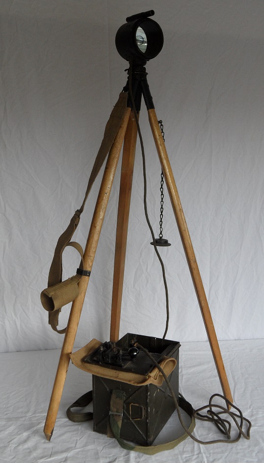

Hello
Here is a ALDIS type of signal lamp manufacturing English, 2nd war.
This lamp allows for the precise morse signaling through the manipulator which is attached to the lamp transport the box cover.
This lamp was also made during the conflict in Canada and Australia.
overviews of the complete kit

Lamp transport box and accessories has two compartments.
Compartment for the lamp, the color filters, and removable foot into three parts. On the cover appears Morse manipulator who is permanently fixed.
Location in the bottom of the box for the color filters and the light attenuator, protected by a foam ring.
Lamp are with power cord and plug housing are output with color filters, light attenuator, protective foam washer and stand in three parts

Technical Manual for the aldis lamp

I would imagine this was a late war production because the Key W.T 8 Amp No.2 is largely Bakelite indicating it is probably No.2 Mk 3
The original key was entirely machined metal on a Bakelite base as you can see in Fig. 3. This was the No.2 Mk 1 but was not marked as Mk 1 (in the same way as a Series 1 Land Rover is not marked as Series 1)
Later keys were cast metal, Mk 2 keys had less metal & Mk 3 even less.
I have three Mk 1, two Mk 2 & two Mk 3 keys & much prefer the clunky rigid click of the Mk 1 than the softer feel of the later keys. I don't use them for visual signalling, they are in daily use on 2m, 4m & 80m amateur bands.

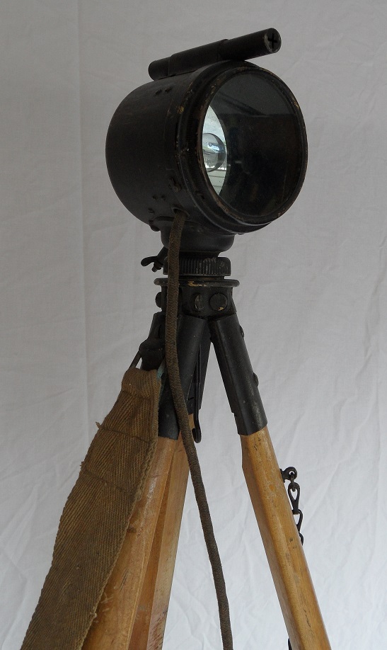

<Nitpick> It's a "Lucas" Lamp (named after its inventor, a Captain Lucas, and not the "Prince of Insufficient Light"), not an Aldis lamp. </Nitpick>
The WW1 versions came in wooden cases (as did the WW2 Canadian version), and there was originally a 12V 'brick' battery to power them, later replaced by the use of a made-up set of eight 'X' or 'S' cells which were standard issue for field telephones, etc. so readily available. The 'S' cells, being manufactured 'dry' could be stored indefinitely but tended to leak once filled if laid on their sides (which they had to be to fit in the battery compartment).
There should also be a similar (less tall) box with an insulating sheet in the lid that contained 16 replacement cells (two batteries worth) for replacement purposes.
Other versions: the "Mounted Services" type, in two leather cases, and the late/post WW2 "Lamp, Signalling, Daylight, Lightweight" in a canvas bag.
Then there was the 'Long Range' model powered by a 10 volt 16AH accumulator, which had a larger lamp assembly (requiring a bulb with a taller stalk to centre it in the mirror focus) and an optical sight.

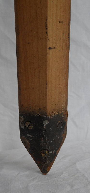

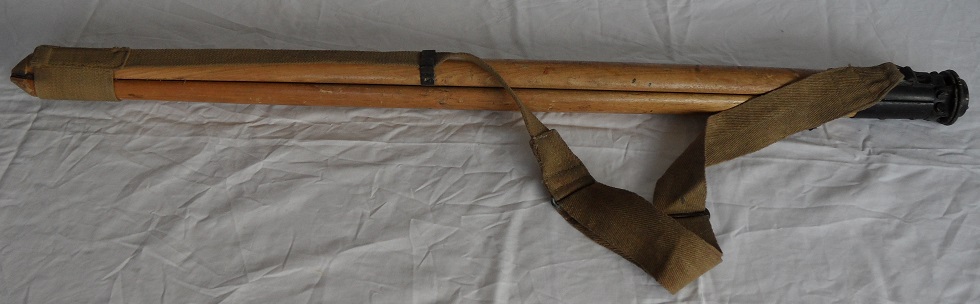

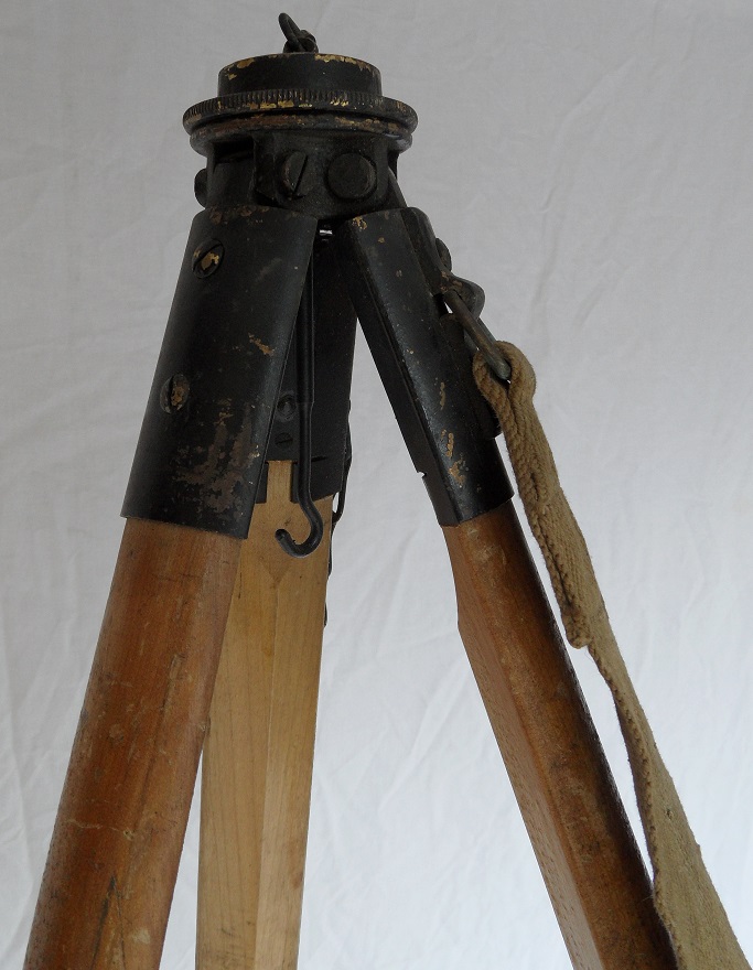

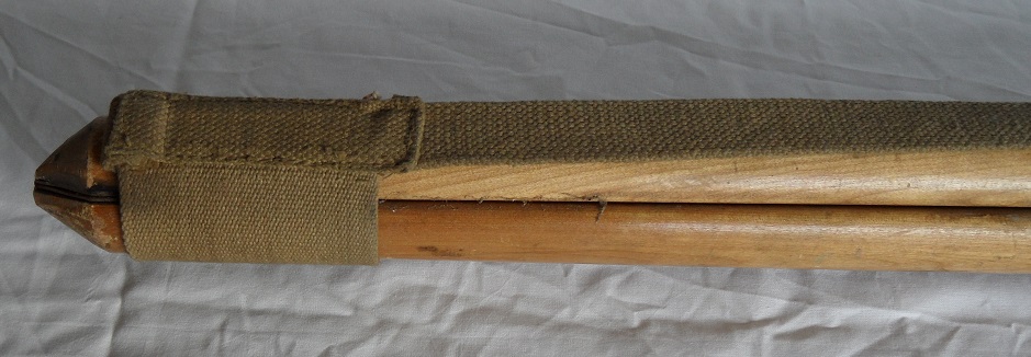

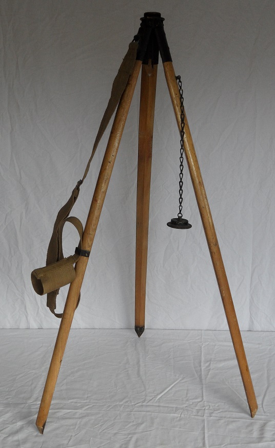

Those are not for the signalling lamp (or heliograph) but they are part of the complete station. That's the telescope tripod for the signalling or scout telescope. (Sadly, the legs are usually shortened drastically by later owners for use with spotting scopes for rifle shooting.)
The Mk.5 has been around for over a century: the one I just looked at (manufactured by Houghton Butcher (a famous camera company)) is a Mk.5 and dated 1916.
The tripod should have a round wooden block on a string to protect the telescope 'jaws' against crushing when not in use, the leather bucket to cover the top (ditto), and a canvas shoulder sling (with a sleeve that fits over the legs) for carrying. (There was also a specialised bit of horse harness for the cavalry to carry tripods.)

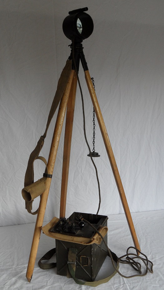

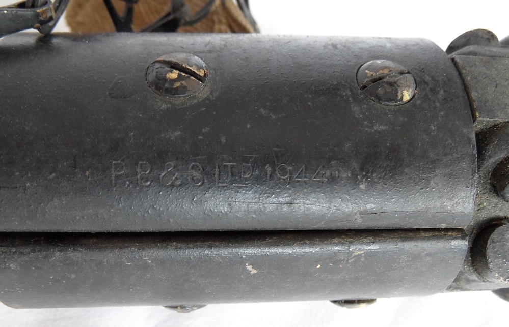

Found a tiny makers stamp
WMC with a N underneath . N would be NSW
FJS & Co Pty LTD 1943 is marked on the leather cap. Aussie disposals had some nice stuff back then . All they have now is ex West German army apparel and other junk. Few years back I did score a few hundred of the Canadian WW2 utility pouches very cheap .
Old 02-03-20, 05:54

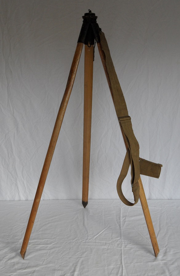

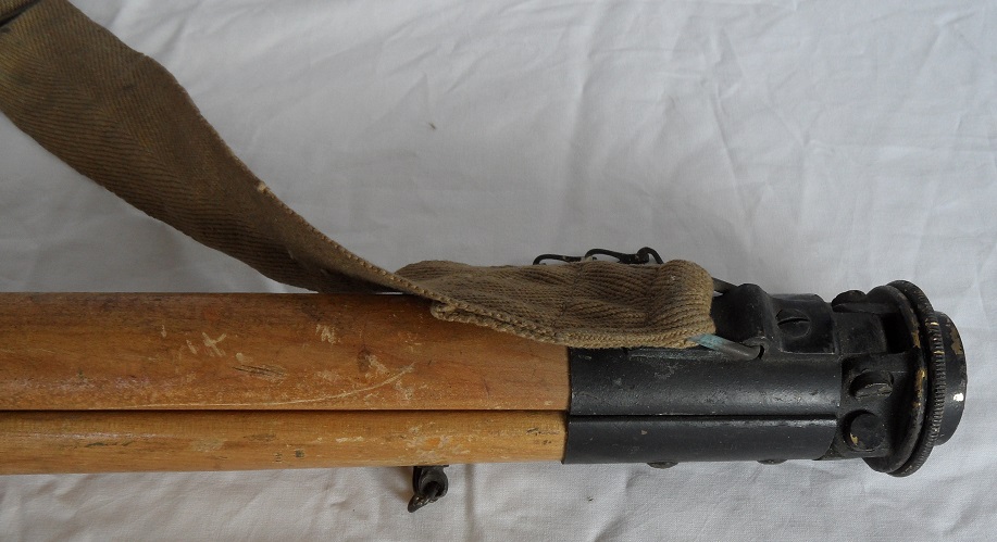

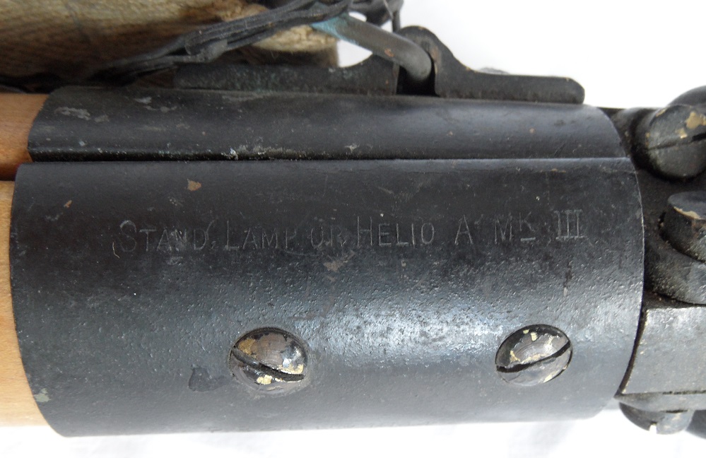

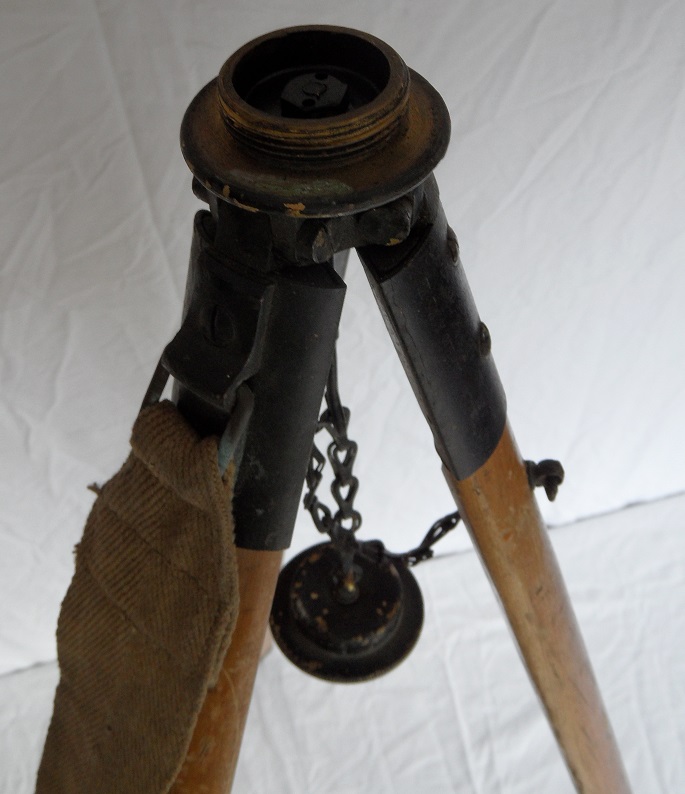

Posts: 6,003
Default Stand
Found the 'stand lamps and helio mk 11'
Marked RMB 1943
