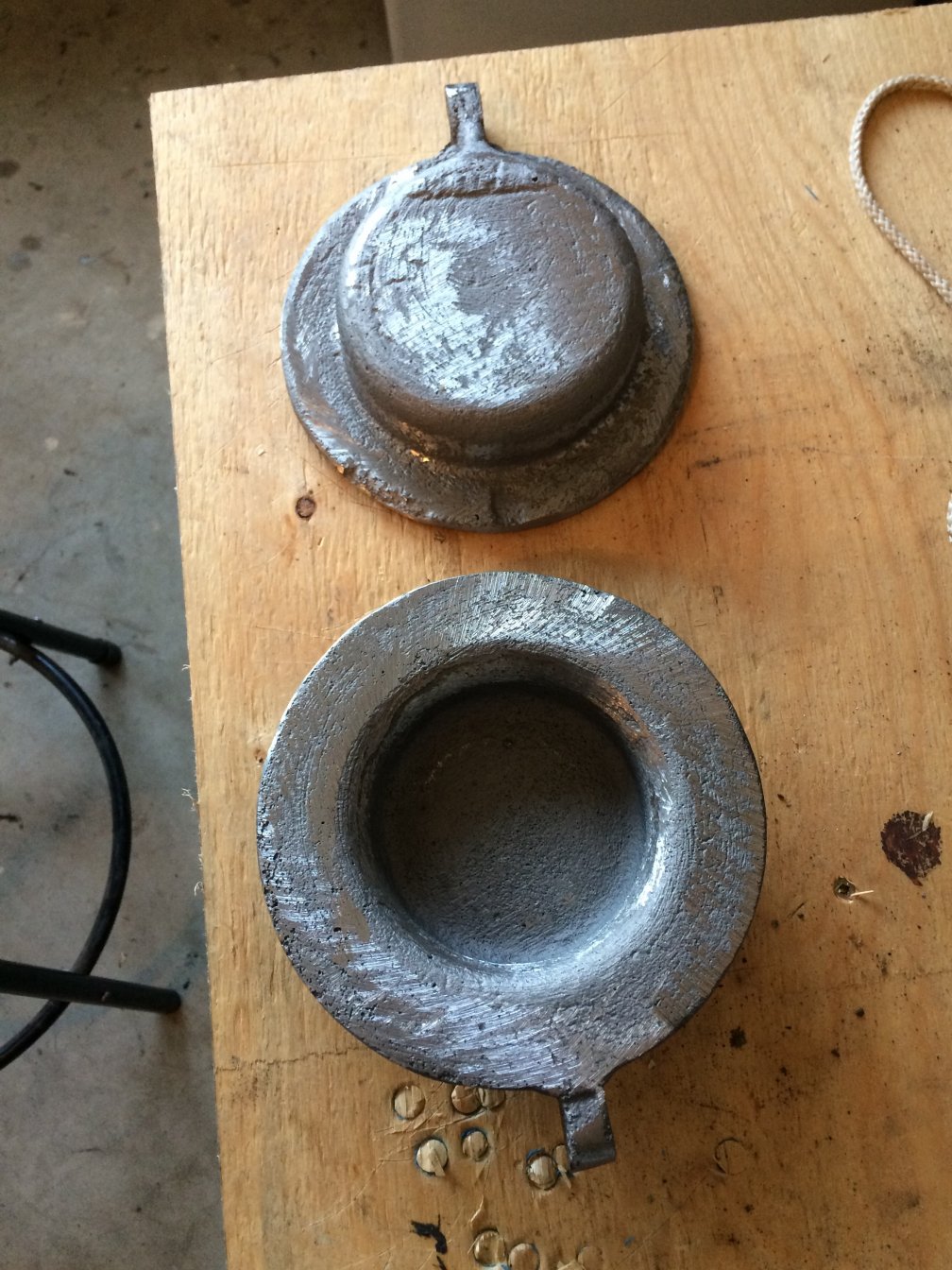

When I first saw my Lynx and noted that both fuel tanks and associated hardware were missing I've searched in vain for the cast filler covers C19SR 9112. To compound the issue the covers are different between Marks of the Lynx even though they share the same part number.
Now due to the "can do" attitude of Rob Love and a very progressive understanding by the curator of the RCA museum in Shilo, I was able to have an original cover removed from their Lynx and shipped to a metal casting company in Winnipeg.
I am now the proud owner of three new cast covers (the price was just too good to stop at two).
My debt to Rob now rivals our Federal deficit.

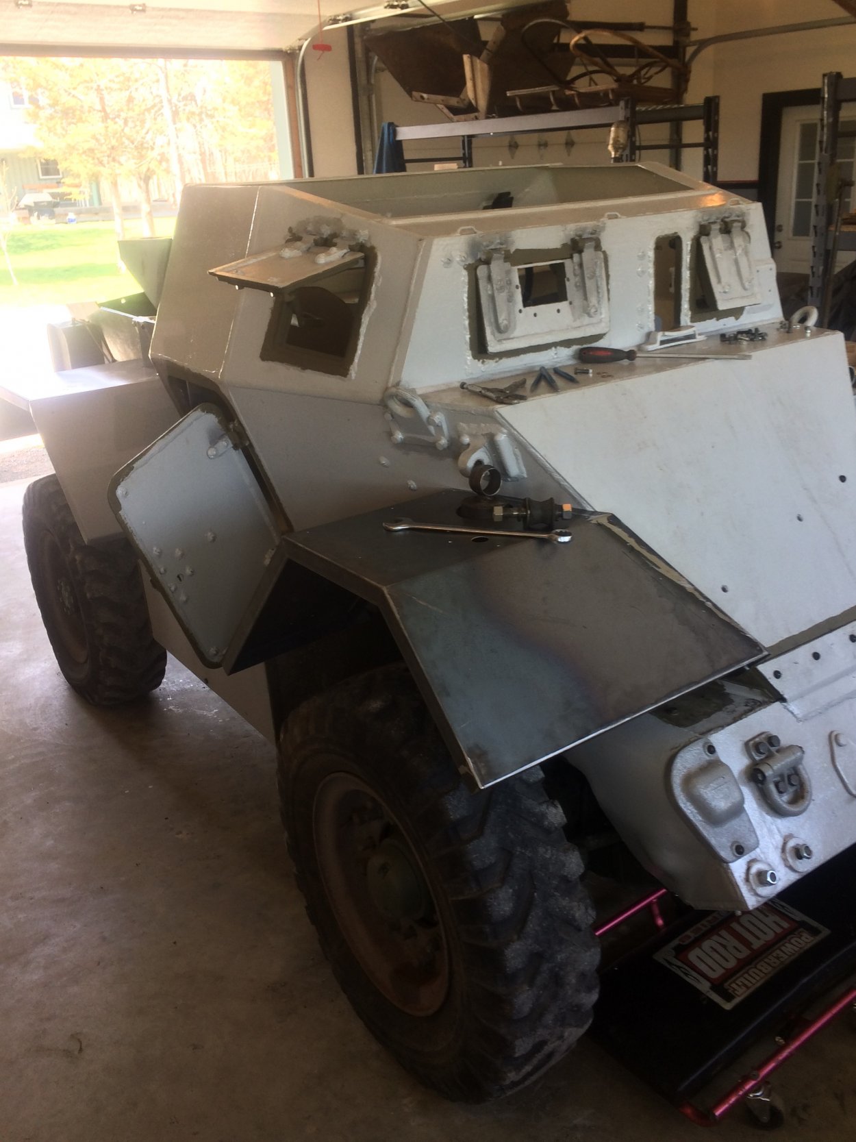

Andy Pomorski, a talented fabricator/welder, fabricated new front fenders for the Lynx, using the old ones as templates. They look great and bolted up without a whimper. The Lynx is now regaining it's pugnacious, bulldog look.
The next step will be the front storage bin. Should anyone have any pictures, sketches or dimensions of the supporting brackets for this bin, they would be quite helpful.
Thanks, Peter
