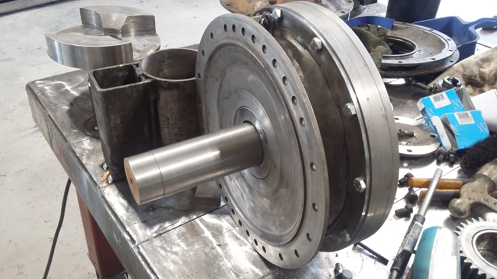

Wow, I will be ever so glad when this part is finished as is so time consuming to get it right. I have machined up metal plugs to go in place where the bearings go and have a centred hole. It all needed to be assembled so I can use the centre hole to transfer the centre location to both sides and it has been no easy task. It maybe the total wrong way but it is progressing. Now that I have the centres I can move on and machine the bearing centre shafts. These recess part way into the bottom housing and a bolt goes through the centre and threads in place. I sure am lucky to have one original.

I had to reduce the size of the gears to fit just below the ring gear. I am hoping to finish all parts for this drive this week so I can get them hardened and back for final assembly and installation.

I have assembled, disassembled, made adjustments so many times I think i'm wearing out the bearings but almost there now. The small shaft with the gear is the final part of the fabrication. I have to get a disc welded to the end and it's not something I can do. The particular steel is called "EN36A" and is wonderful to work with and can then be hardened anywhere and depth required. The piece that needs to welded on the end is also the same material as I found out that if it is not compatible it will fail and the welding process is extremely specific and not within my ability. It must be welded with special rods, heated to 600-650deg, covered in some kind of sand with regulated cooling. As this small shaft it the final drive "FAILURE IS NOT AN OPTION"
and not a time to cut corners. Anyway, it will be off to the specialty welders tomorrow, get it back Monday, off to the heat treaters Tuesday, get the parts back some time next week then it will be the final assembly, engine, tracks and so on.

Of course the picture are about face. Anyway after the disc is welded to the small shaft I will need to face it off on the lathe and then drill, dowell and bolt the clutch housing to the end. There will be some serious torque on this part.

Colin,
What are the dozen or so small holes drilled radially half way along the shaft ? I did wonder if they were related to the indexing of the gear teeth but although it is hard to see, I think there are less holes than teeth so not that.
  #955
Old 08-11-18, 21:34
colin jones's Avatar
Posts: 1,810
Spot on David, they were for indexing. I was going to machine them off but as it made no difference I thought I would just leave them there. All the other gears had them too but needed to be machined off.

Back to the serious stuff I have completed the centre shafts that hold the bearings for the gears. I have changed the design as the original is very complicated and from what I can see is unnecessary. The material used is the same as the gears but I won't be getting them hardened as they don't move at all.

Each shaft is held in place by the recess top and bottom and there is no way they can move whereas the original is held in place by a wedge bracket and bolt. The last photo shows the heavy plate/bracket which needs to be bolted down to the underside with a series of bolts. Very strong once completed.
