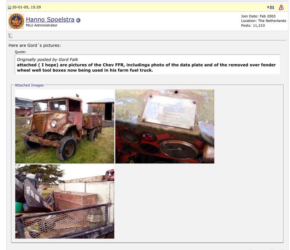

It only took 5402 days or 14 years, 9 months and 16 days to bring these parts home. From a post on the this very forum way back in January 2005 to last night is the time it took to track down and get these original Wire3 storage bins here. A huge huge thanks to Stewart Loy and to Rob Love for helping in the transport. It always amazes me just how helpful others are in this great hobby. And to think the bins were made in Brantford during the war.

Old 05-11-19, 21:14
Posts: 14,974
Your persistence has paid off, well done!
Would love to see your WIRE-3 after it is finished.
  #672
Old 06-11-19, 02:48
Happy to have been able to help you out, just as many on this forum have helped me over the years.

Rob, I appreciate it to no end. Same for Stewart and Machine Gun Mary
