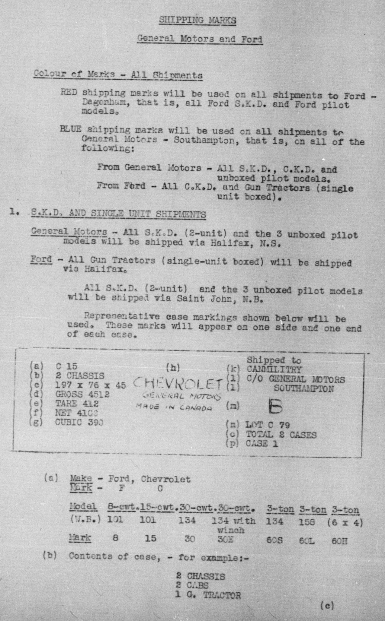

Join Date: Dec 2009
Location: Barrie, ON
Posts: 422
The initial instructions for shipping marks, and destinations can be found here: https://heritage.canadiana.ca/view/o...reel_c5142/459
551F5088-DB83-462D-8F5B-6D12E2AF6B98.jpeg   C8C1BB33-BC92-48EE-AF17-C1D232230EA3.jpeg   2CCC85EE-B805-476F-9DDE-590D36109CD9.jpeg   072FFD64-BF3D-4B1E-941D-ED96036C826B.jpeg   A9975C5F-2164-48ED-88F3-4E22B2472E5E.jpeg
