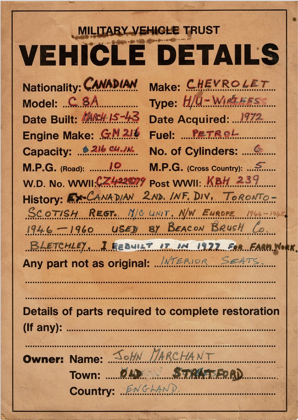

A number of technical data are known about this vehicle, but some data may still be missing.
Therefore, if possible, I would like to exchange ideas with you to obtain the correct information about this vehicle.
Some information known to me is listed on a data list (Vehicle Details) of the previous owners, Mr. John Marchant and Mr. Johan van Rijn, see photo. Also a photo of the dashboard.
Well, I found the same chassis number on the chassis. The engine number does not match the chassis number plate. Now the engine number is PR3831815.
I still have to find the dimensions to make all the steel cabinets.
I would like to hear if all this old technical data can be correct.
I think you already know a lot of history and technical details about your HUW. In fact, much more than other CMP owners often know. If you do not have it, I will dig our John Marchant's "work and play with CMPs" booklet and see if there is additional info in it. Possibly Ed Storey can chime in as well.
It was quite common for engines to be changed out, so the fact that it is now fitted with a different engine than the one which was fitted in the factory is nothing to be concerned about.

John had a Diesel engine in it in the beginning , and later put a Stovebolt Chev engine back in it , outside Olive drab and Brown Camo where found under the paint by John

"Order no LV 309" is listed as a contract placed by the Canadian government as CDLV 309 - see the full list of C8A contract here: Chevrolet Heavy Utility contracts. CD stands for Contract Demand, LV is thought to stand for Land Vehicles.
Here are two known serial numbers from that contract:
  • 2844515234 ENGINE # FR3838709 L.V. 309 AUGUST 14 1942 [C-HU-441-M-WIRE1] Z 65-479
  • 2844515470 ENGINE # FR3866568 ORDER L.V. 309 NOVEMBER 17 1942
I have not seen this type of data plate before. Are they copies of the original ones? The second plate should not be on a C8A, as the info relates to a C15A 4x4 truck.

Hello Hanno, it took a while but I am happy that I took the step to participate in the MLU forum. (my English is for what it is) The knowledge of Chevrolet and Ford CMP Vehicles still leaves a lot to be desired. I am often faced with a challenging surprise.
Hi Maurice, the fact that a diesel engine was installed in the past may explain the (many) cutting work on the chassis, frame and floor plates in the cabin area. The vehicle has changed color several times over the years. All in all I came across 4 different colors of paint.
However, on the chassis near the rear engine mounting I found, in my opinion, a reasonably traceable first layer of paint. This emerged after removing a thick layer of oil and grease.
Hi Ed, the lettering will be entirely in accordance with Toronto Scottish. The photos of this will follow soon. On older layers of paint I could not find any characters other than Toronto Scottish characters.
What I also cannot figure out is the meaning of “W/T” on the right front door. This was on the old visible layer of paint. However, I couldn't find anything on the first (bottom) layer of paint. On a layer in between there was only a “W” behind the W.D. Number.
Hanno, now you investigate the type plate on the dashboard.
This was the plate when I bought the HUW from Johan van Rijn. In addition, the two original plates as in the photo. I don't have any other type plate. This may have been removed at some point as a souvenir. I intend to have a NOS type plate printed with the correct information.
Assuming that the chassis number stamped on the chassis is decisive for me, I understand as you write that the Order Number (CD)LV 309 cannot correspond to the year of the chassis number? That should perhaps be (CD)LV 308.
If I look at the engine number on the nameplate (FR3891254), I think that the production date corresponds to the nameplate.
I also cannot determine the date on which the chassis number 2844------ (1942) changed to 3844------ (1943). So chassis numbers with 2844------ were also made in early 1943?
All in all, I think that all information is correct with the possible exception of Order Number 309.
Can anyone tell me at which chassis number LV 308 ended and at which chassis number LV 309 began?
Thank you for your positive responses.
Regards, Bert

Bert , the chassis number was not factory stamped in the frame , it was only on the ID plate on the dash.
About the collor , they where deliverred in 3 basic collors: dessert sand , service brown , and a brownish olive drab .
If they arrived in partly knock down, and got assembled oin the UK , they would be sprayed in Olive drab with cammo (mostly only the outside ) if you look at period pictures from storage aeria`s you will see they are in the same shade and cammo .
Late arrivals after D-day would be left in olive drab , and mosly stayed in the units uncamouflaged .
