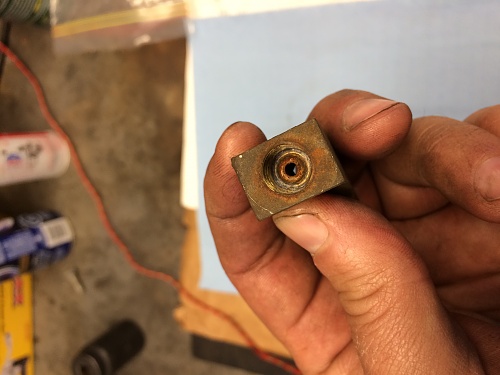

So I reread the relevant sections and I think the retaining pin now makes sense me. Does it keep the centring pin from dropping down into the axle? Once that retaining pin is out the centring can drop down and the centre ball can now fall out. Initially I believed that the retaining pin actually held the centring pin in tight. This was my confusion.
A62D7C98-F4D2-4944-B1AA-242B661DB8D9.jpg   CC870DDF-C5B6-44FF-BD8F-D209CB077C62.jpg
  #542
Old 04-04-19, 20:17
Default Think you got it
Hi Jordan
I believe you are correct the second or cross pin holds the center pin from backing out in the passage and letting the center ball loose.
Will have to look at my disassembly pictures to see if I can find something of uses.

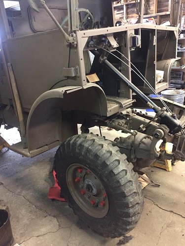

So I finally managed to get the king pin bearings installed after a few hrs of frustration. I realized I had done some minor damage to the ball socket when removing them in the press. The hole for the 928 bearing outer edge had been squished ever so slightly. This kept causing the bearings to go in and then grab on one side. I fixed it up using a sanding drum in my dremel going very slowly until the bearings press fit in.
With the time I had today I did get the left side CV joint back together and mounted in the inner and outer knuckle. The pivot pins went in fine

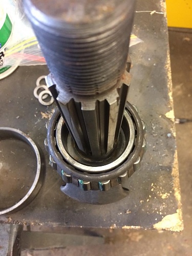

Two questions that did come up due to not taking enough pictures.
In my first picture you can see the splined shaft, then the grease slinger and then the bearing cone. Should the raised lip on the grease slinger be facing the bearing? If the lip is towards the CV joint the slinger doesn’t sit flush. The second question is about the bearing and it’s fit on the splined shaft. It sits loose on the shaft with a considerable gap. Is that gap supposed to be there? It does match up with wear marks on the slinger

Regarding your question about the bearing fit on the splined shaft. The bearing should be a press fit on the shaft. Same as the corresponding cup should fit tight in the bore. You want the rolling elements of the bearing to do all the work, not the inner or outer race spinning on the rotating parts.

The following refers to those parts circled in the red on the exploded parts drawing. The parts lists referees to the bearing cone as Timken #462. This is what I removed from the knuckle when I first pulled it apart and have since ordered. The new and old bearing match up.

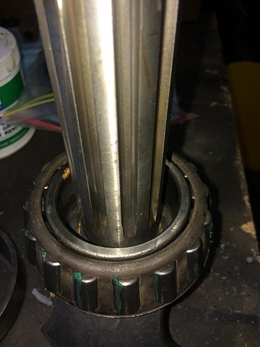

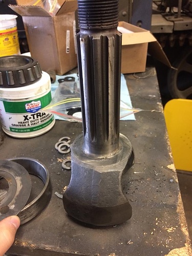

Here is the axle shaft in question. Both sides are the same. This goes from the CV joint to the hub.

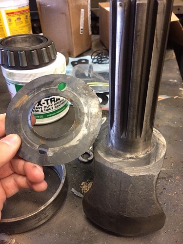

This is the grease slinger. My understanding is that it fits on so it sits flush against the shaft. The lip would point towards the splines.
Here is the original Timken #462 bearing cone. This was my concern as it has quite a loose fit. However the wear marks on the grease slinger match up to bearing surfaces.
Last shot of the left side assembly all together on the bench.
  #555
Old 10-04-19, 19:07
metal urgest
Join Date: Sep 2008
Location: London, Ont
Posts: 465
Jordan,
Is there something on the hub that fits into the cone when assembled? Surely that splined shaft can't be left flopping around inside the cone.
  #556
Old 10-04-19, 19:15
Posts: 4,188
I just had a eureka moment with your comment about the hub. Yes there is shaft on the hub that fits into the gap between the splined shaft and the bearing.
  #557
Old 10-04-19, 19:33
metal urgest
Join Date: Sep 2008
Posts: 465
Bingo!!
You have just won a Kewpie doll!
  #558
Old 10-04-19, 20:48
Posts: 7,633
It is that piece, (6.3075 in the parts photo) along with an appropriate amount of shims, (6.3076 in the photo) that sets the front wheel bearing preload.

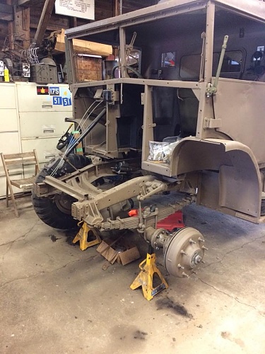

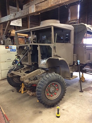

Now that my head banging moment is sorted out I managed to get the left side knuckle installed. Using the idea from both Phil and Rob for using the shop hoist, things went very smoothly. The felt retainer bolts are quoted in the manual as being torqued to 30 foot pounds. I did this, for all the other ones I couldn’t find any reference to torque specs so I went wih 50 foot pounds. I also sorted out the safety wire and got the 4 bolts all wired up.

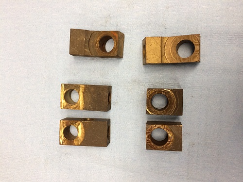

Lastly I’ve got all the original brass brake junction blocks to go back on. Any suggestions on cleaning these up? I’m thinking that sandblasting them will be to hard on them?
  #562
Old 12-04-19, 01:52
Posts: 2,323
For the exterior surfaces a wire wheel on your bench grinder should be quite fierce enough - basically rubbing off any little bits and polishing the surface. For internal passages a drill bit held/twisted in your fingers to clear any solid bits. For the thread and seat areas - handheld wire brush, gentle picking, perhaps spray brake cleaner would dissolve hardened or dried on brake fluid.
  #563
Old 12-04-19, 02:09
Posts: 7,633
Shining is wearing. You do not want to distort the sealing ring areas, nor pit the areas where the flares of the lines go.
  #564
Old 12-04-19, 02:11
Posts: 7,633
Front drums went back on and then I followed the bearing pre load steps in the manual. After installing the wheels I can feel very very very minor rocking in the right side. The left side has no rocking at all. I’m thinking the drum may not have fully seated on the splines.
Either that or you have too may shims in between the two bearings. Try and remove one and see if the play goes away.

It never had any shims in it when I took it apart. I’ll try it on another spline and see if it seats better.
As for the brake junctions. I’m not really worried about the exterior. I just wanted to get the small bits of compacted rust out from inside the flare ports. I’ve got the bits soaking in some evapo rust solution.
