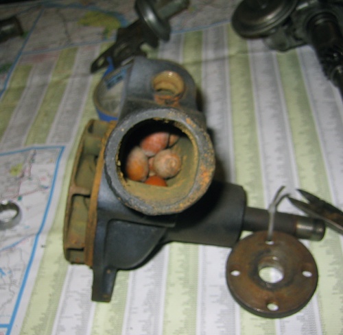

Hi
The solution for difference in location of water pump on later 235 and 261s is an adapter plate.
more on the adapter plate see http://canadianmilitarypattern.com/2...ifications.htm cost of the plate is small compared to the time to make one. Here is the guy I purchased my two plates from pre68bowtie@hotmail.com .
The time consuming part is finding the correct water pump with the short shaft and the correct size pulley. Short shaft is necessary for clearance to the radiator and the correct pulley size is to keep the fan speeds reasonable, should be the same as the engine RPM.
Hope this helps.

The adptor plate shown above works with the 1942 or later water pump which can best be identified by the angled outlet and the two holes in the original backing plate. If you want to use a similar plate with the earlier pump used on CMP 216s (identified by an outlet parallel to the ground and a single hole in the backing plate) you will need to make it yourself. If you choose to make such a plate, pay attention to the clearance for the bolt head that is more or less hidden behind the outlet.
