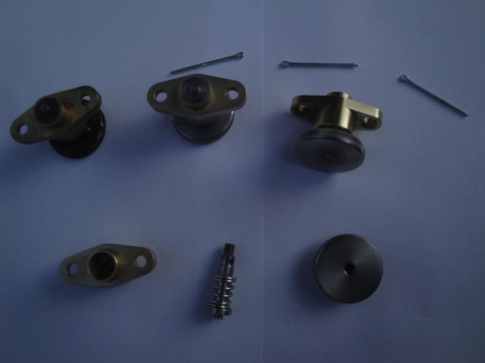

today i received 3 reproduced shutterbuttons,those were copied from a original button that i have borrowed from dirk leegwater.
they look amazing good and working very nice.
the factory have all the drawings,so if somebody need them i can order them.
don,t know off there is some interest,let me know.
roy

Does anyone know if the brass part is the same as an LP Carrier?
I know the button itself is different, the English one having a radiused edge, the LP being virtually flat across the edge.

Yes, I do, and no they aren't.
Old 06-06-12, 12:13
The knobs are square edged
The bronze part is longer between the screw hole centers.
The screw countersink is a different angle.
The spindle is a bigger dia.at the index (business)end
...and the arm is different, and so is the window frame.
Things you can interchange;
Bogie axles and bearings
return roller axles and bearings.
steering box worm and sector shaft
Fibre cups.
Suspension rods (with nuts)
Not much else.
Roy , you have done a nice job. Well done!

Ahhh, Red, if anyone was to know it would be you.
And yes the suspension rods are interchangeable, but the threads on the ends are different. So to be 100% authentic, you shouldn't be using English rods in an LP Carrier and vice versa. *shakes finger sarcasticly whilst staring at pile of NOS English suspension rods cleaned up to go into LP suspension*

Old 06-06-12, 13:01
As they were available in your area, why wouldn't you?
....and when your carrier is up and going, will you care?

They look great! I am assuming British are same as Canadian!?
Either way I am interested! How much are they?

because we ordered only 3 off them the price was a bit high
the more i order how better the price (as always)
i called the company today,but the boss is on vacation right now.
when he is back i let you all know about the price.

finaly i get the price today.
each button is include the shaft, spring, knob, base and the little lockpin
when i order :
10 pieces : 103,50 euro each
20 pieces : 91,50 euro each
30 pieces : 80,00 euro each
40 pieces : 66,00 euro each
50 pieces : 60,00 euro each
these prices are not including shipment
roy

Sorry I will have to pass for now. If you have dimensions That would be great I have a mini lathe and mini milling machine and this is the size of stuff I can do myself if I have a pattern or drawing.

i think the price is to expensive
before i put the price in here there was a lot of interest,now it is over.
and indeed with all the work on them is 60 euro a fair price.
