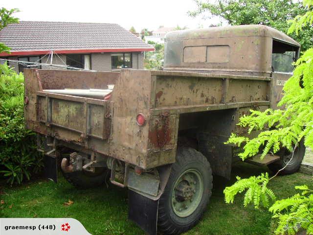

Default Cab 11 Blitz on NZtrademe
Looks like the seller is in the dark about it too.
http://www.trademe.co.nz/Trade-Me-Mo...-168276981.htm
Old 30-07-08, 13:19
Stuart Kirkham's Avatar
Join Date: Mar 2007
Posts: 268
He says that he doesn't know much about 'this beast' but he sure knows a lot about 'asking heaps of money' for it.
Old 30-07-08, 13:26
Posts: 14,970
What is it, Ford or Chev? It has 4WD and 16" wheels, but is it a 15- or 30-cwt?
Old army truck
Asking price: $2,500 | Closes: Thu, 7 Aug
I dont know to much about this beast other than it is taking up to much space in my shed .Ask some questions and ill do my best to find out.
Location: Waipukurau, Hawkes Bay

Does that front bumper look as though it had the front bumper bar suport, making it a Chevrolet? Unless it arrived in Kiwiland post-war, I wonder if it is a # 11 cab issued to the NZEF in N Africa, then sold and transported onwards for the Pacific campaign?

its a ford tell tale signs the radiator cap and dash panel and front towing eyes.As for size im guessing its a 30/60cwt as i think i can just make out the top of the rear spring mounting and its quite a distance from the petrol tank where as on a 15cwt there pretty close to the tank
luke
F15A 11 cab x2
F15 13 cab 20mm polsten (under restoration)
Old 30-07-08, 18:34
Posts: 14,970
Thanks Luke!
My guess is a 30-cwt as it has 16" wheels.
David H., what can you tell us about F30 11 Cabs being delivered to NZ forces?
Old 30-07-08, 19:50
My guess is a Ford with a Chev front bumper. Ford has four holes for the bolts that hold the grille guard and Chev uses two. You can see where the guard was bolted on the front of the bumper too.
It's a Ford radiator with the outside ends sloping back and the cap going through the hood.
Chevs have a bigger hole in the sheetmetal for the crank to go through too.
The dash is definitely Ford.
It looks like the curve of a Chev rear end under the bumper but that doesn't mean anything on these early models ( no vents) anyway.
It looks like you can see the front spring hanger just behind the gas tank so that would make it a 15 cwt.

I agree: the dashboard-panel is Ford, that sure,
the radiator cap also indicates that it's a Ford.
the tanks seem to Ford too.
I think it's a cwt 15, not sure, perhaps better photo's would show more, but i have a lot of question's about the backside, selfmade? And that mirror!
The cabine is a 11, that's sure, and a very early one too! (no vent-holes!)

That is quite an unusual and uncommon vehicle in this part of the world .
Looking at the chassis rail, it appears to be a 15 cwt .
These very early production vehicles were a slight mixture of Chev/Ford bits . On my C8, there are a few bits here and there with Ford part numbers .

I'd go with Hanno on this one and say it's an F30. The forward rear spring hanger on an F15A is virtually right behind the fueltank.

If it's a # 11 F30 then I suggest it was one of the 1200 delivered to Egypt for assembly (in Alexandria) supplied under S/M 2003, and then issued (then sold)to the NZEF/NZ Government. There is a photo of L 4406114 in WHEELS & TRACKS # 49 accoridng to my notes.

According to Trademe the Item has been withdrawn from sale by vendor. It was a direct sale not an auction, so maybe it was listed elsewhere.
It was a very tempting truck, I have always like the 11 & 12 patterns, there are quite a few in rotten rows around the place but I only a few in restoration, most are Portees, a couple of FAT's and some 3tonners so would have been a nice addition to any collection.
The biggest problem is it was in a very rural part of New Zealand, If you have a map of the North Island and find Napier on the East Coast and following the main road south and inland to Palmerston North, Waipuk is around Half way so fairly expensive to recover. Still....., as he dreams and then comes back to reality with a dull thud.
