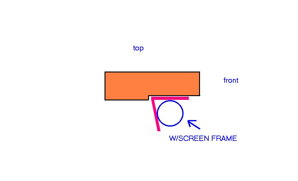

Old 15-10-08, 03:54
Posts: 6,040
Default pics
Chuck
these pics will help you.
The original section of wood that fits across the top of the w/screen, has a shallow rebate in it .. the angle metal you see sitting on top of the tubular frame is supposed to fit into the rebate . I used a flat section of wood as I didn't have a router on hand to do the work. So , what you end up with is that angle metal piece should be flush with the wood.. sit in it rather than on top of it as in my pic.
Old 15-10-08, 04:10
Posts: 6,040
Default Drawing
A QUICK DRAWING OF WHAT I AM TRYING TO PUT INTO WORDS !

Default Hold up!
Before you proceed any further Dave, a MLUer from Manitoba, Bill MacKenzie had the complete frame and running gear, sans body for a C15A for sale. If you're interested, I can dig up my emails to him and see if he still has it. Derek.
