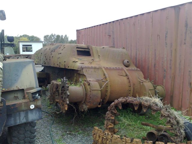

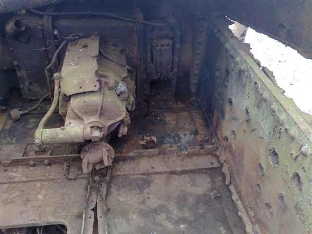

Default Pics
Here are a few pics of what we have started with !
2008-09-04_11-08-20_04092008343.JPG   2008-09-04_11-08-34_04092008344.JPG   2008-09-17_09-44-56_17092008411.JPG   2008-09-17_09-45-52_17092008414.JPG

Thought you would like to see where we are at with the restoration so far. Hull is stripped out, lots of hull repairs being carried out, busy refurbishing wheel stations etc.
Progress is good but slow! hoping to have it running and driving middle to end of this year.
Carl

Hi Carl,
Thanks for letting us know about your progress. I see Adrianīs welding manipulator is being put to good use again, must be at least the third tank it is used for?
Canīt wait to see it running, I do not have to tell you yours will be the first Ram Kangaroo restored to running condition ever!
Attached goes another "before" picture to show the forum members what you started off with:
Keep up the good work!
