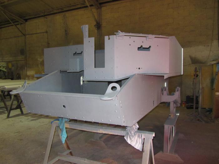

Hi, Got the mortar carrier back from the blasters today, Zinc primed ready for the first under coat came up fine with no holes or repair required, noticed a bullet hole in the rear left side armour, also a bullet mark in the front gunners armour.
Also the number 1433 stamped on the front side armour, see pictures attached.
First job is to take off the suspension units for rebuild.
kev.

Hope to get it rolling within 12 months, set myself a target.
