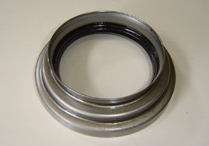

Seal "no.5":
NOS leather seal.
Measurements:
OD: 6.25"/ 159,8 mm
ID: 4.5"/ 120 mm
Part number: *C01Q-1190-B
Part name: Seal - front axle hub grease leather oil seal
I bought these locally as NOS leather seals for EUR 10,- each.
EDITED TO CORRECT: this is not Part number *C01Q-1190-B as that cross references to SKF/ CR 49998 with ID 5" and OD 6.25"

Old 29-03-09, 20:33
Posts: 14,918
Measurements:
OD: 6.25"/ 159,8 mm
ID: 4.5"/ 120 mm
In cv joint Bob posted a picture of this seal, with I presume a modern part number written on the piece of paper.
Next picture the seals.... again readily available.. inner at $10 and the big 6.5 in at $25...... if you have difficulty getting them let me know......

Old 05-06-11, 13:35
Default Seal 5
Yep, this is the one you need to replace when you see grease and oil coming out of the brake drums. Amazingly they seem to last about 60 years.
Seal "no.5":
NOS leather seal.
Measurements:
OD: 6.25"/ 159,8 mm
ID: 4.5"/ 120 mm
Old 05-06-11, 13:41
Default Or the....
Just a guess but this looks like the transfer case power take off seal.
Yes it also looks like the F15 hub seal.

Old 29-09-18, 23:30
Posts: 14,918
Look up cross references to modern SKF Chicago Rawhide seals here:
http://www2.chicago-rawhide.com
Old 29-09-18, 23:33
Posts: 14,918
Using the link above, this one cross references to SKF 45150:
http://www.skfextranet.com/catalogs/...il.asp?s=45150
Seal "no.5":
NOS leather seal.
Measurements:

Old 05-10-18, 20:42
Posts: 5,259
Default Front axle grease seal
Just did an inquiry....... 35 in stock in Toronto listed at $114. CDN each.
Ottawa business price at $57.64....part number 49998 6.25 OD x 4.5 ID available on 2 days notice.
One current manufacturing use is for bread making machines!!!!!!
Bob C
Old 06-10-18, 12:11
Posts: 14,918
Not sure if you're quoting the right number?
SKF 49998 has sizes Shaft 5" and Bore 6.25": http://www.skfextranet.com/catalogs/...il.asp?s=49998
Old 06-10-18, 17:10
Posts: 5,259
Default Will need to check on Tuesday
Will verify with the supplier on Tuesday....... could they be overlooking the 1/4 inch rubber skirt on the inside...?
Will keep you posted.
Old 12-10-18, 00:42
Posts: 5,259
Default Correction...Hanno is right....
The seals they brought in was the wrong size.
DO NOT USE 49998...... 499 stands for 4.99 inches inside diameter...
PROPER PART NUMBER IS 45150..... WHICH MEANS 4.51 inches inside dia.
....and of course they had them in stock and the price is $60.35 CDN plus taxes which comes out to $136.39 for two.
Plus shipping to where ever??????

Old 03-08-19, 06:46
Posts: 5,259
Default Correction......
The 45150 number provided by Hanno and Rob ARE the correct numbers.......also fits C15a and HUP front axle available from SKF.
[IMG] code is Off
