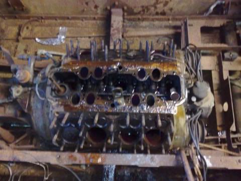

took the heads off the engine and poored AT fluid down the pots, then took the inlet manifold off and filled the valley with the same fluid, I used this on recomendation from a carrier collector from Thunder Bay needless to say the engine is severely clogged up and after some gently prying on the crank it was obvious that this is going to be a full rebuild. good thing is the block appears to be good and is holding fluids. Engine comes out when i can scrounge a hoist able to take the weight !

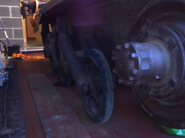

managed to get the gunners side track off, basically as i have been working on my own i have had to improvise somewhat, so i removed the sprocket tied a strap to the track tied the other end to my tow hitch and slowly drove away pulling the long section off without incident. So far i have about twelve links which need broke free, i have free'd the rest off. That said looking at the pins i have knocked out they are pretty bad i dont think they will be safe to run so i may have to steel Kevins pins...........Just kidding mate....... will have to make some new pins..
noticed that both my rear bogie wheels are caput, i thought it was just the rubber that was perished but the beading on the rim has been smashed out on both wheels in various sections, so they are goosed to say the least.

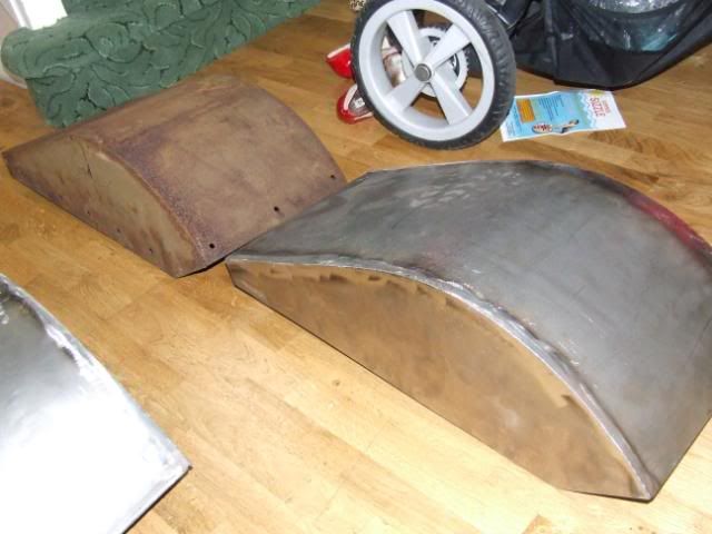

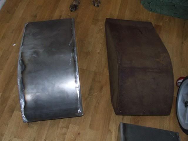

have a source that can make front and rear fenders and the fender skirts so i have farmed that job out will wait and see what the quality of the repro is like if its good will let you all know who did them.

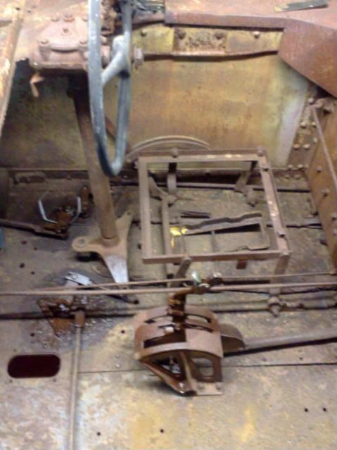

Right managed to get the rivets out, i used a wafer thin cutting disc and took the heads off the rivets from the inside, they punched straight out no problems, and through patience and a steady hand i might add there is no marks left behind from the grinder. i had tried for over an hour with a new drill set but the rivets although mild steel were killing the drill bits off in minutes despite slow speed drilling and with oil.

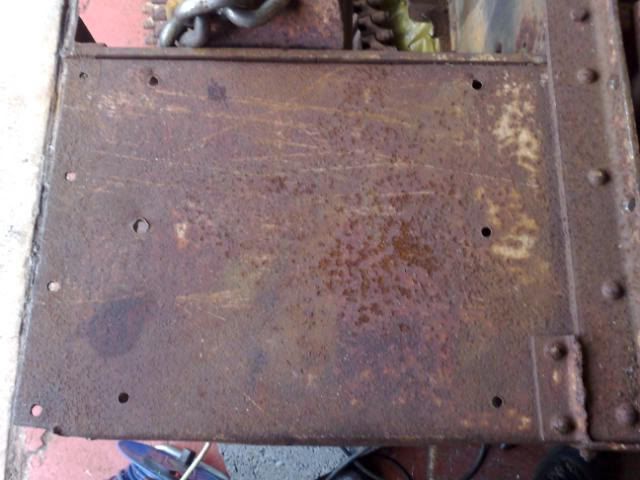

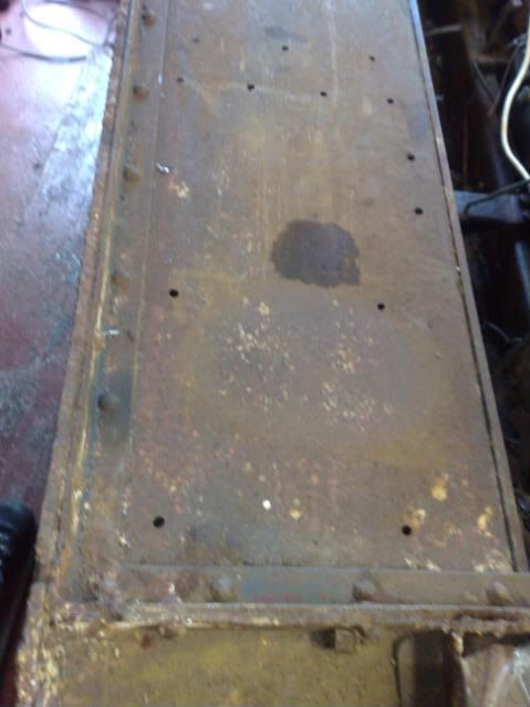

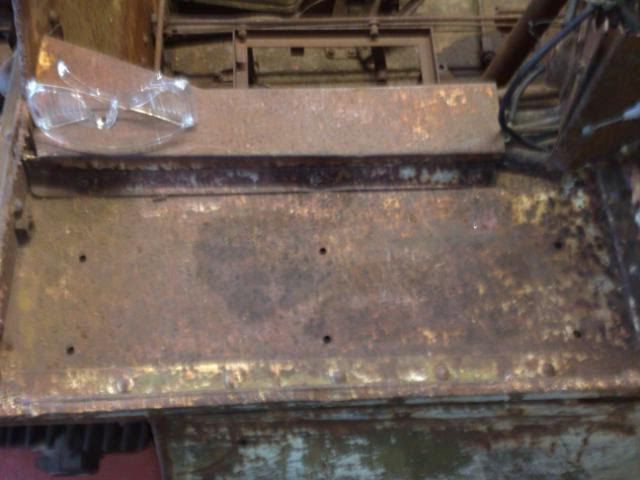

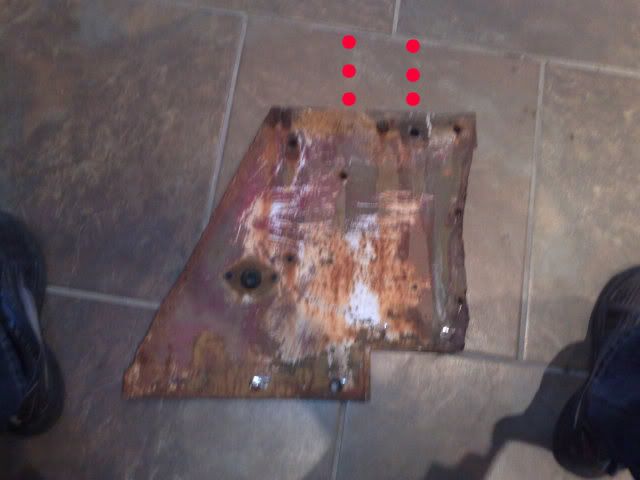

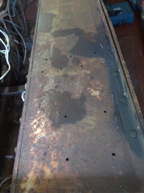

whilst working on the tub i noticed loads of holes, wondering what they were all for ?
thought i would post them up see what you think.

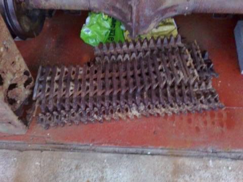

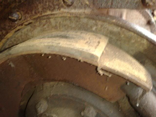

anyway here is the brake shoes and gubbins for the gunners side.
and the holes..... there are a load on the gunners side, but as all my tools were there i will get photos soon.
drivers cockpit
drivers side rear part of tub (looking from front backover)
drivers side rear part of tub (looking from the rear forwards)
and finally the rear drivers side track guard sits over the sprocket
i know holes could be drilled for any number of reasons and by anyone, just trying to figure what if anything she has been fitted with. i know she has had the radio as the rear armour plate i have left has the holes and evidence of the battery box .

hi rich, that first pic, holes for drivers side ammo bin, holds down the three straps on the bottom of the bin. Last pic are the holes for the ration box tray, you have the remains in the bottom right corner of the pic of the crank extension holder, best to take out those brake shoes wearing a face mask and bag them up, hoover out the drum housing of all lost dust and pressure wash the rest, you can refit the asbestos shoes later.
I have attached some pics of what is fitted to the holes.
kevin.

If you look up from the uderside,you will find all the holes are countersunk.
If you put bolt heads or nuts under there, the track will wipe them off.
Id say that all those holes are original.

awesome. cheers for the replies guys ! it is like a pandora's box this thing so many little things you miss on a particular day only to discover later. Gantry should be ready this week to drop the tub onto (it has strong castor type wheels with breaks) once the axel is clear and the lump out i will be able to push it in and out the garage easier, i can pretty much push it now, even with all the weight in.

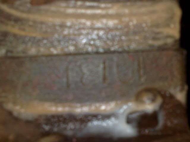

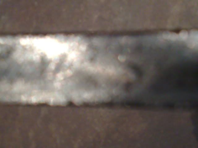

finally i may have found the serial number or part of it (unless it is wishfull thinking)
the actual number can anyone show me a picture on the top edge of the armour ? the "ghosting" that i can see contains a five but the number is towards where the dash pannel cover would be ? just wish i had photographed it ! i will try and put some acid on to reveal any stamping evidence.
the area i beleive i can see the numbers is as below
my armour has been cut straight down level with the dash pannel then it slopes in from the outer edge of the hull to the outer edge of the dash pannel.

Is this what you want? your location is correct.

cheers Lynn. the number i can see is faint, i will try and recover it with acid, fingers crossed ! would any of those number have ben covered by the dash pannel top plate ?

I dont think the number would be covered, but I'm not sure.
I don't know if you've already done this, but try undoing the mounting bolts/ nuts for your bisector / brake adjuster. soak around them with CRC and try chasing them back out of the backing plate, as you try to draw the brake drum off. If there is a groove or shoulder in the drumthis may make it easier to get apart. Another thing you might try is bolting a bit of steel bar accross a couple of you sprocket mounting holes, so that you might be able to rotate the drum.
You can put a shouldered plug into the end of the axle tube to pull the hub against, being carefull not to do any damage to the thread of the axle tube. I would remove the outer bearing first.(I note you have) Then you can "woble " the hub as you pull it. It's a frustrating struggle, but be patient or you'll damage something, thats hard to get.
I would get hold of a good fitting tool to back of that brake adjuster. the force you put on it maybe enough to nudge the shoes into moving, and if you can back off the adjuster, it gives the shoes some where to go.I would do this first.
When removing rivets, note where the flattened ones, and the flush ones come from. there is always a reason. Something won't fit later.
When rebuilding the bisectors, be very careful at assembly. They can be assembled wrong and in that case will be ineffective.
If your cam plate is rusted on the working edge it can be built up with weld.

thanks Lynn, will give it a go, once i have made significant progress i will post up some more pictures.

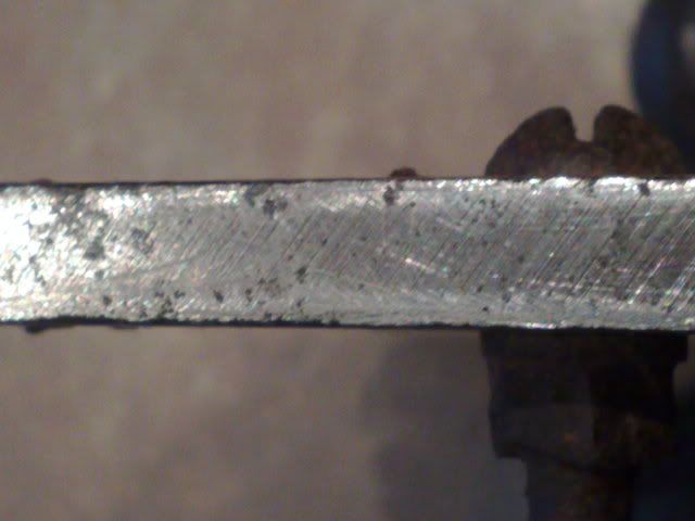

right, i managed to get the remains of the front plate off, i cleaned the top edge up and used some scotch brite I can see a faint "T" as apposed to "CT" a faint 5 and a faint 2 perhaps this is wishfull thinking or iam seeing what i want to see..... the plate goes into the SMV unit at work tomorrow for chemical and heat treatment.

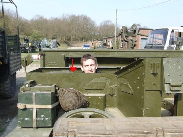

i took a photo of the plate section but the camera cant pic up the detail.
between the red dots is where the ghosting appears, the T the 2 and the 5 are very clear i tried to zoom in but the camera is basic. hopefully i can recover it !

well the plate has gone to work they have tried copper sulphate type acid solution with electric current with brings up the numbers, they say they have recovered a 4 but are struggling so i said they could try heat but to photogrpah it first. we will wait and see i guess.
i have ordered some pullers to get the hub off so waiting for that. managed to rip my boiler suit (which was wrecked anyway) so went onto ebay and found a nice olive crewmans suite so paid a few pennies and got that, popped my grandads Div flashes on it when it came , just to keep in with the theme

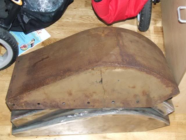

used one of Kevins NOS fenders to make a pair as mine were wrecked, just need to drill the holes they are direct reproductions using same gauge steel etc etc.
I can create more of these if people require, they will come with holes or without and will be red oxide primed (if anyone needs some)
