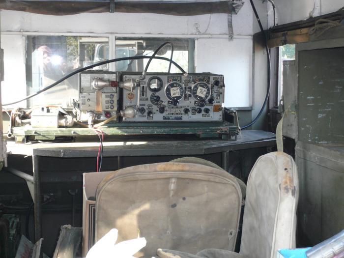

Here's some inside shots of a restored HUW. I'd love to tell you who it belongs to or who to credit the pictures to but I don't know.
If you want interior bin and seat details I can copy and send you the drawings I have for my HUW project. Basically there bins on either side, two crew seats on simple bases that face right and left and an operator's seat that is more complicated and faces forward just behind the wireless table. The seats and table are removable, held to to floor with wing nuts. The generator sits in a cabinet on the upper rear left side and is accessible from two outside doors and an inside sliding panel.
As for kit, I've never seen a stowage diagram but figure the following would have been carried:

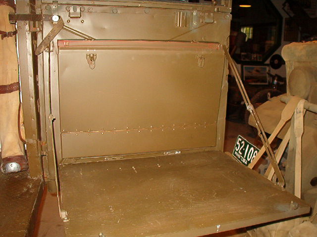

Hope they will help you out. These pics may be on past forum threads???
Right side back
Blackout curtains/table
Missing battery box's
High Power not installed on top of 19 set

Default My folding map table...
Bruce, I will PM you with measurements shortly. I used CMP window hinges for table hangers, so it is far from original. Phil, the back floor plate is a slightly thinner guage than the cab and is unremovable, both with the same pattern. I believe it is original floor plate to the truck. I sure would like to see a HUP/HUW/HUA etc...Wireless addition to this forum. Just a thought. Cheers Rob

The map table is original?? Looks NICE!!!!

Default I repo'd the table... 19 Set High Power...
it's pretty close except for the hinges. See pic of 19 set High Power installed. Missing microphone/headset hangers on ceiling. Cheer Rob

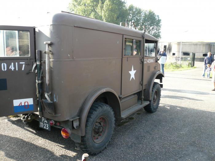

Attached you will find some pictures of the HUW that can often be seen on shows in the Northwest of Holland. I understand the truck was once restored by the father of the current owner, before he passed away. You will see that rust has since claimed a piece of the truck.
@Mike, I send you some more pictures of this truck by email.
p.s. Rob, your truck looks brilliant!

Some reference pictures of a Dutch HUW.
