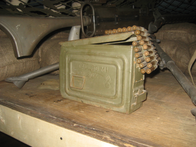

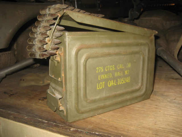

Originally Posted by Michael Dorosh View Post
Did the Canadians manufacture their own?
Yes I think so, see the pictures of an orginal 30 cal. ammo box for our "Canadian" FOX.
Mvg. Dirk

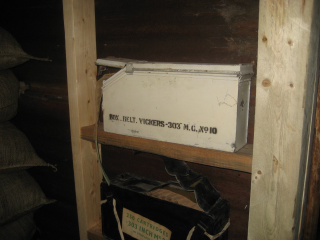

Old 29-11-09, 18:29
Posts: 1,733
Default Box, Belt, Ammunition, M.G., No. 8 Mk I
Any idea what this box is for?
Old 29-11-09, 19:45
Default Fox 30 cal. Box
Dirk, I think your 30 cal. box is unique to Canadian Fox. It seems to be patterned after the British Besa Box.
Can you see any trace of black lettering on your box? The Fox 50 cal. box was stenciled "50 CAL." on the front and it follows that the 30 cal. box would have similar markings. Is there any sign of lettering on the front or the top? Maybe both?

Old 29-11-09, 19:47
Default Vickers
...and I'd give it a good home if it was surplus to you needs.
Bruce
Old 29-11-09, 20:42
Posts: 1,733
Default Vickers
A vehicle mounted Vickers?
Old 29-11-09, 22:26
Default Both
Could be either. Often the linked belts came in wooden boxes similar to the regular .303 rifle ammunition.
Bruce
Old 29-11-09, 22:54
Posts: 1,733
Default Ammunition Boxes
The H51 Box is generally considered to be the common box in which belted ammunition would have been supplied to a ground mounted Vickers MG. Being manufactured of thin plywood, the H51 is much like the US M2 metal ammunition box in that although the intent was to recover and refill the boxes, many were not. The construction of this No. 8 Mk I box tends to lead me to believe that it was designed for an AFV and that it was intended to be refilled and reused as part of the vehcle's equipment.
