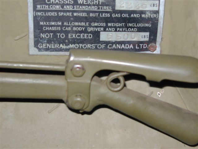

I wrote to Flathead customs and got a reply.....
sorry for the late reply, the data plates are on the side of the Engine cowling drivers side. condition solid canvas like new, we rebuilt the top end of the motor runs fine had the gas tank cleaned and coated it had bad gas in it don't know how long it had been there but it was nasty. its had brakes all round just need bleeding to finish, let me know if you need more pictures or you have more questions.
Regards Mal
Here are some of the pics .... experts can point out the shortcomings...

Default rear body
Hi,
The rear body is from a 1930's-era 1.5 ton US military truck. Have seen this type on Dodge and Chevrolet's.
Thanks, David
Old 19-01-10, 06:05
You can see a couple of the grounding straps under the hood so it started out as a wireless truck.
The serial number is 58 higher than mine and the engine number is 144 higher than mine.
The side window openings have been modified and they've added that rear crossmember.
The rear troop seats have that park bench look about them.

Default troop seats
Hi David,
Troop seats are not original to this bed. Note the inverted "U" shaped welds on the inner bedsides under the existing seats. The original bed had brackets there for seats that have been cut off at some point.
Thanks, David
