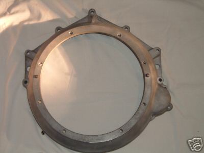

Default Converting bell housings left to right
I have had good luck in converting standard Chevy left hand bell housing to CMP right hand clutch fork. With extra CMP bell housings being scarce I needed to convert a US Chevy NOS housing to accept the right hand clutch fork location. While the conversion is not as easy as converting an original CMP bell housing to left hand, the original Chevy bell housing were cast for either side and only the machining determined which side.
To convert a bell housing for the other side it is just a matter of carefully drilling and tapping for the clutch fork ball stud and cutting out the side opening for the fork arm. Alignment of the ball stud is rather simple with a couple of center bolts and compass the location can be copied from a CMP housing. In my case I used the very tired and very cracked housing from my C60L. Cutting out the rectangle for the fork arm is done by carefully drilling each of the corners then cutting between the drill holes, careful cutting don’t go past your pilot hole to prevent a cracking point. So as to take up the strain of the ball stud I made a tapered washer so that the lip of the ball was flatly grounded all the around.
If anybody needs more details I’ll post better pictures.

Old 01-03-10, 23:16
Default More photos of Bell Housing conversion
More pictures

Default Hydraulic is and option but time involved
Hi All
Robert's point is a very valid option Hydraulic slave cylinder will work. And if a different engine and bell housing may be the only practical solution.
I would love to see how they handled the widespread conversion of Chevys to Ford engines in North Africa that is mentioned in one of Bill Greggs book.
Now back to Chevys bell housing conversion time involved is at most 4-6 hours will be one of the major savings over conversion to hydraulic. The tools necessary to covert a Chevy bell housing from right side to left side are relatively simple and are as follows and.
Tools
1. Measurement bolts with heads cut off and spun in lathe or drill press to mark the center of the bolt end these are then threaded through the mounting holes on the bell housing measure with a compass to transfer the location to the new housing.
2. Drill hand or drill press
3. Drill Tap of the correct size and thread for the ball stud
4. 3” masking tape to locate the left side fork port and mirror to the right side confirm corners by basic measurements.
5. Air cut off saw to cut between the holes of the lever port – alternate to drill series of small holes to insert saw blade (slower but works)
One other point if at all possible replace the clip spring in the fork that hold it on the ball stud, these are available from many antique Chevy parts houses. These springs get tired after 60 years. When the springs are tired they tend to allow the fork to pop of the ball stud, particularly while you are adjusting the linkage.
