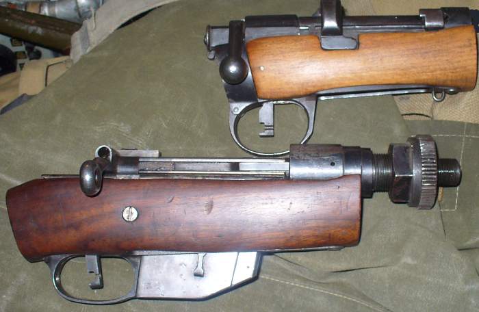

Here's a picture of the Canadian Ross and British SMLE dischargers. Note the 'NO SAFETY' safety on the left side of the SMLE. The idea was to use a modified rifle safety to keep the bolt in, but not stop the action from firing. The real safety was a cotter pin at the other end of the cable inside the vehicle.

Ron, lovely pic of your carrier and the SMLE type discharger. It seems there is a number of people who have modified an action of sorts to build what they need. Thanks verra much for the offer of addition photos. I will drop you a note if required.
Bruce, thanks from the forum for posting your pics. Both excellent examples for others to study and learn. My quest is to have the correct rifle action (with proper trigger/safety mods), tube, and "Bowden" cable mech if necessary. Any further details for the Ross M10 action and subsequent mods necessary as they apply to the MKII carrier application would be most helpfull.

Just to be clear and say it....these dischargers are cut down rifles and are very prohibited and illegal in Canada. They must be deactivated to the firearms guidelines and pinned and welded as mine are.
