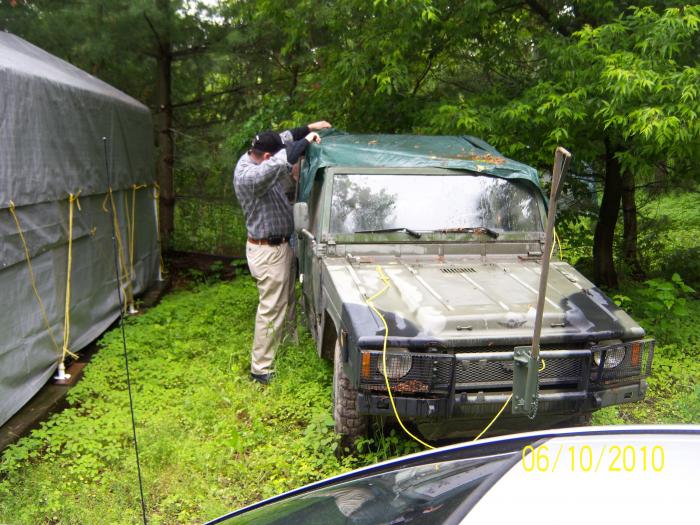

One of the good things about being "between contracts" is that I get to spend more time at the barn. With the new house pretty much set up to the missus' satisfaction, I have spare time!
This Thursday turned out to be quite exciting. After spending a few quiet hours working on things metallic, I heard a car splashing along the barn access road. Visitors!
Clive Law and Don Dingwall stopped by to pick up Law the Younger's Iltis. After removing the swimming pool liner, Clive connected the batterys and tried to start her up. No such luck. Fuel was added to the tank and some was dumped down the carb. The little green truck roared to life and then died. This noise attracted the Hammond airforce in great numbers. It seems they only attack clean people...
So, after much swatting and fuel supply trouble shooting, we cleaned the carb's interior and gave her some more gas. The little truck roared to life again and stayed alive at high revs. After a few minutes she managed to idle at a reasonable rate of rpms.
Clive added some new veterans plates to the truck and Don drove off in search of more fuel. Clive chased Don down to Cheney and nothing more was heard. I trust they made it back to Ottawa as Clive posted last night.
You never know who will show up at the barn...
Photos:
First - Clive and Don (well hidden in back) remove the pool liner from the Iltis.
Second - Clive just after having his bell rung on the roll bar.

Nice to hear that another Iltis is on the road. I hope to see the Iltis at Bob's BBQ in a few weeks time.
The big trick with starting the Iltis is to pull the choke on (left side of steering wheel). It also helps to pump the gas a few times, and pull the manual throttle half way out (right side of steering wheel). If the engine rpm is too high, reduce the manual throttle, till it warms up. Don't forget to push the choke back in once it is running OK.

Default Thieves ??!!
Young Law:
Thanks for the new community Iltis. It'll be well used till you get back.
Got your trailer at my place too.
Rob:
We did indeed make it back---all the way out to West Carleton. Aside from losing the speedo around Hunt Club and Bank (we don't need no stinkin speedos...) it was a trouble free drive---except for the idiot behind me (Old Law) who nearly ran into the back of said Iltis when monetarily distracted by a live human female (something he's obviously not used to...)
Stu:
You're spot on. Figured out the whole choke throttle business by the time I got to the gas station in Cheney.
And thanks to Gilles (http://www.militarytrucks.ca) I have all the manuals I need during the reconditioning process that has already started with a new windshield.
Neat little rig that Iltis. I might just keep this one for myself!

Don, you can keep the family M38 in lieu of the Iltis. Consider it a gift of thak you for working on my toy!

Rich:
I'll wait till your old man gets the engine rebuilt, then I'll take possession of the 38!
Bob:
I suspect I'll be at the BBQ at some point Friday or Saturday-we're hosting a baby shower Saturday here at home, so I'll have to do some juggling.
Clive wants to have the Iltis for the BBQ but we need a right front brake line first.
