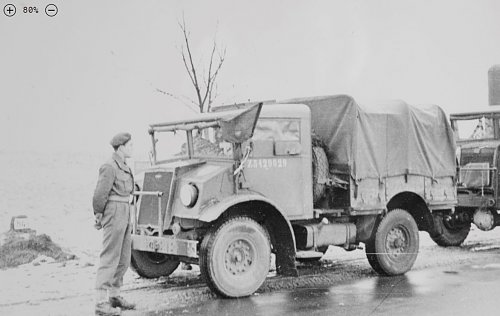

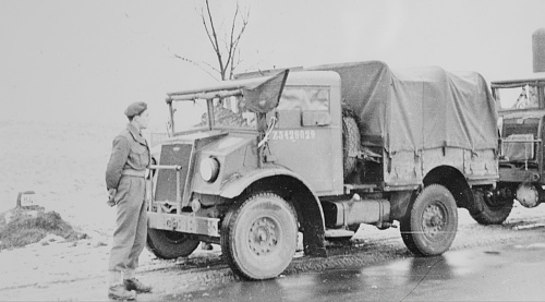

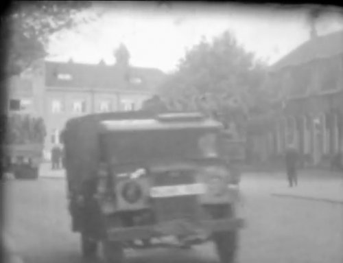

Posts: 275
At least a 4x2 on 39 sec.
https://www.youtube.com/watch?v=O0VumA283eA

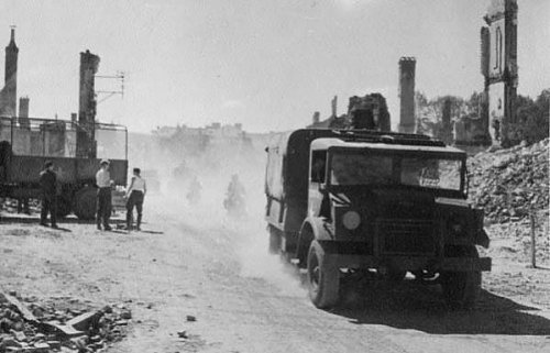

Old 23-04-15, 15:59
F15 in Alkmaar 1945. However...is it British or Canadian?
The second picture of the Jeep and Fordson were taken on the same day and on the same location. Fordson and jeep are clearly marked Canadian.....so F15 as well???
Source: http://www.regionaalarchiefalkmaar.n...beeldcollectie

Old 23-04-15, 18:08
Posts: 14,940
To my knowledge, it were Canadian units which took over control of the Western part of Holland after the German surrender. So, I'd say the F15 was in Canadian use.
Another great find, you are "good busy"
