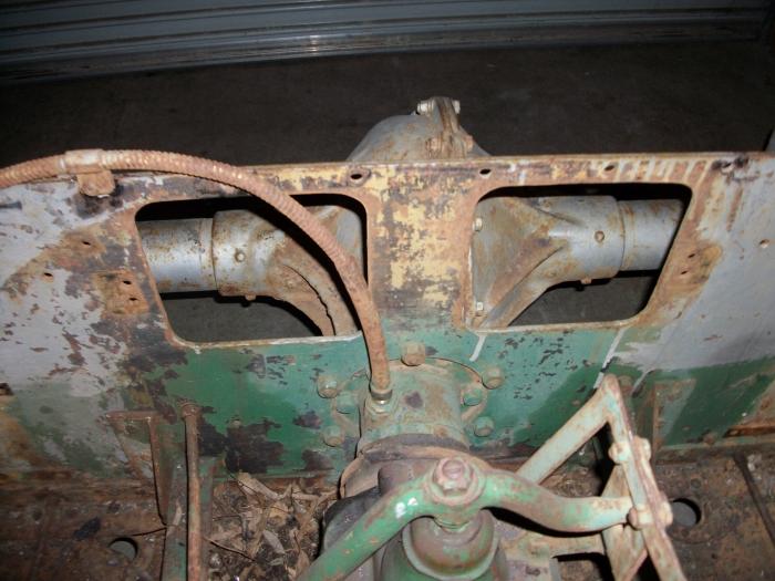

Yeah Richard the carrier in the shed is my project at the moment was driving till just recent now pretty much just striping down for a rebuild can't find no body numbers but some feed back i've had seems like it's a English 3inch Mortar Carrier

How about some photos of her, inside and out. Show me the engine bed rails, and the rear panel( above where the diff bolts on, the top)

Lynn attached are the rail photos, if you have an idea about numbers being here im doubtful myself. I have checked at the back of the front gunners plate and above the drivers vision hole with no luck. does have painted number outside front drivers side.

If T58362 is accurately the number of the thing, it was indeed a Universal Carrier 3 inch Mortar Mk 1 manufactured by Sentinel Wagon under contract T2035 (info courtesy of Nigel Watson's Universal Carrier Vol2).

You wont find any stamped numbers on the hull, because the Brits didnt do it. She is definitely a Brit carrier,because the bed rails are made from channel steel with a square outer corner, the Canadian ones are a rolled section.
From Nigel's book (Vol 1 in fact) that contract was for a batch of 360 Mortar carriers. I have no doubt about the "T" number (T58362) being correct. There are other carriers in Australia from the same batch, if my memory serves me correctly.
You have a lot of original bits in there, and she should come up well. Keep posting. You will find some good help here.

Hi wayne, I have pulled a picture fron Alex Van wetering's Overloon Conger thread, which shows the mortar carrier rear panel with the universals many holes blanked off with short rivets. (factory done) If you look at Brian Johns thread you can see the two battery cable holes are also factory blanked
